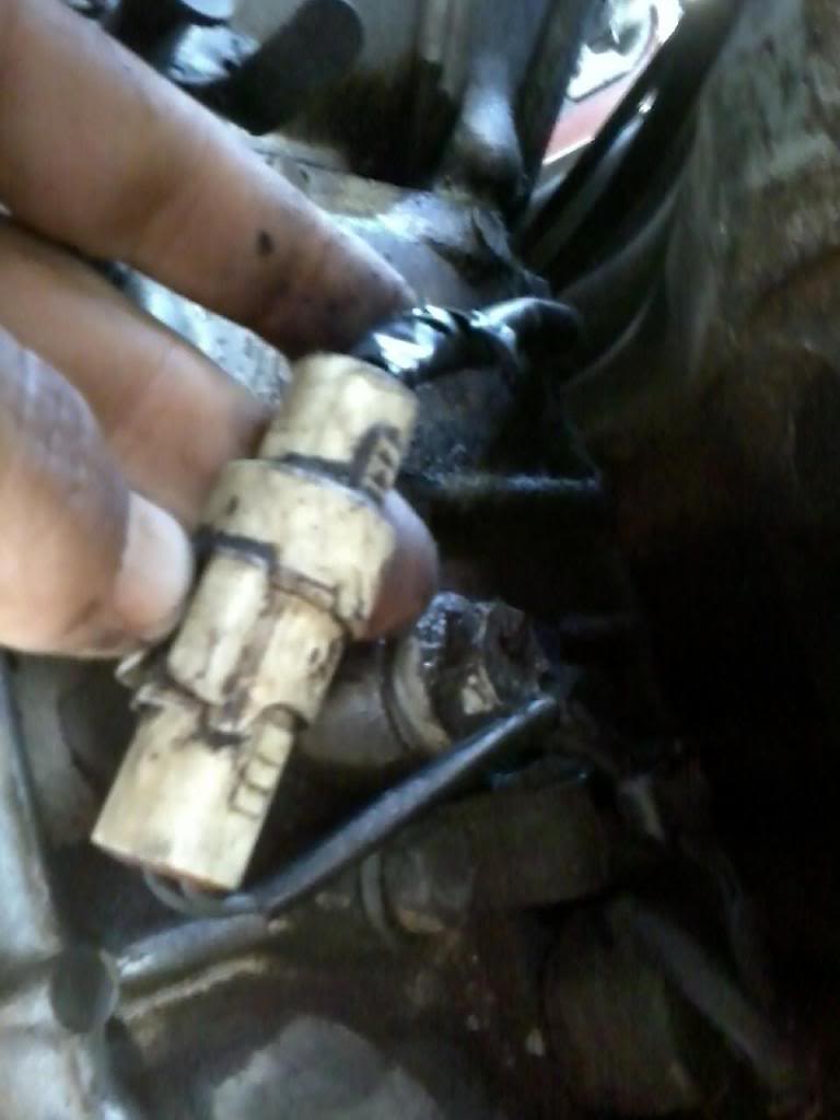

I had a similar issue. Here is how I fixed mine. Is your ENG fuse blown?
FIXED!!! Mine was the Reverse Lights on the Tranny. It has a protective sleeve and depending on how the sleeve slides, it can cover the wires where they rub against the tranny leaving them exposed. Below is other fixes for this problem.
A possibility if "fan blower, Speedo, tach, and temp gauge" share the ENG fuse. Gotta look at schematic.
However, regardless of what O.P. finds out, I highly recommend inspecting that because wiring to back-up light switch is poorly routed and design could be better (switched ground would make it safer), as shown here.
