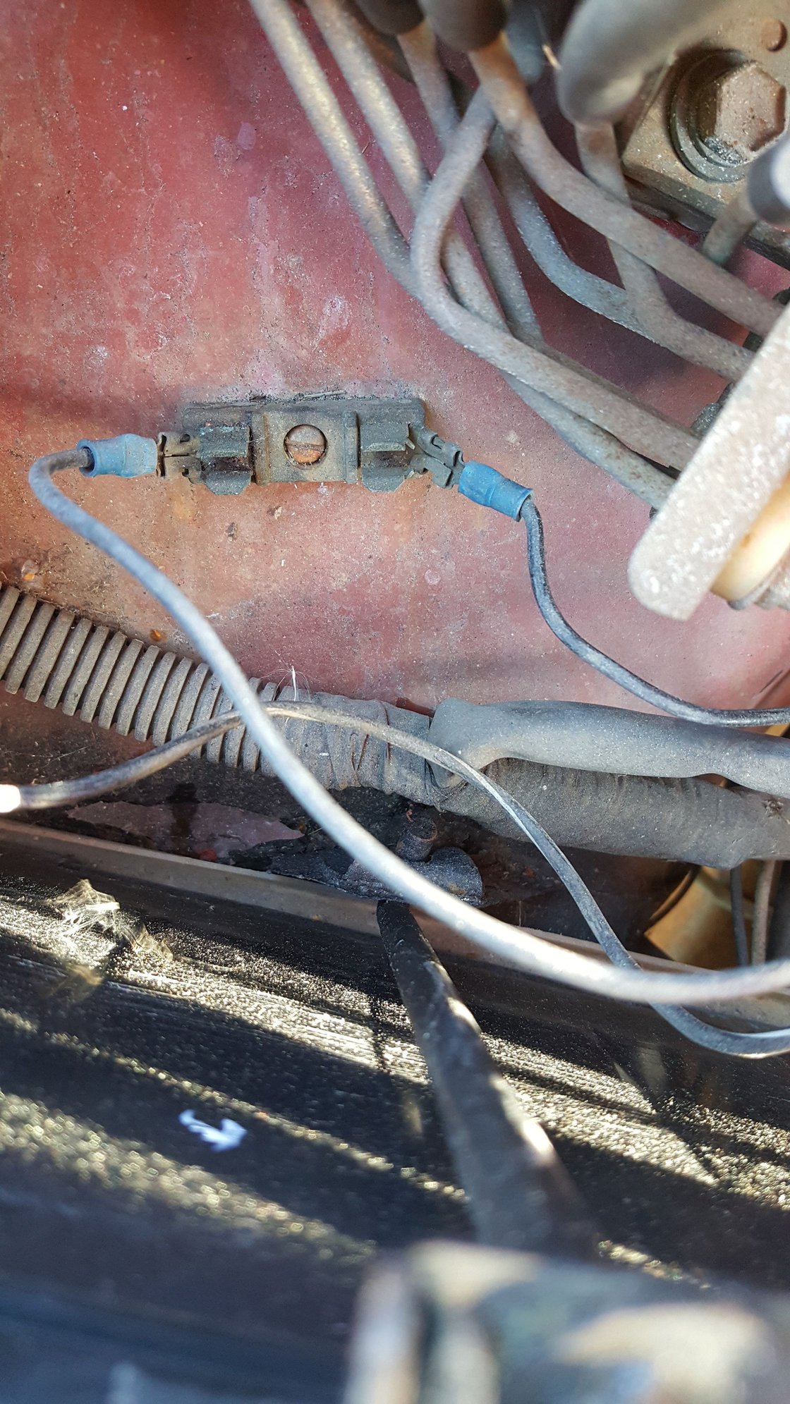

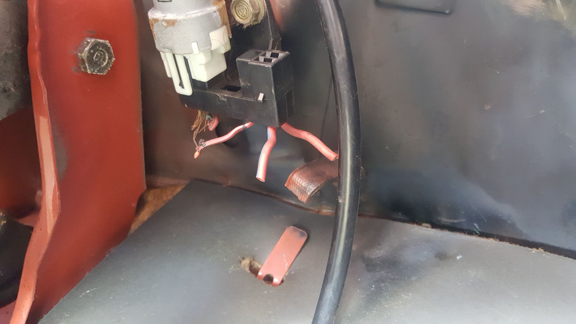

More pics of wiring from front of Truck
Hello to all,
Thanks for all the responses. I will be looking into the solutions you guys have provided. I am attaching some more pics from the front of the Truck. The first pic is of the battery with the fusible links coming off of it, (to the left background shows what I think is a fuse holder) Battery, fusible link, and wiring. Not sure if fusible link is connected correctly
fuse holder? one lead goes to the fusible link, the other to perhaps the 12v 30A relay?
Relay? I believe, mounted in front of battery. I think one lead goes to the fuse holder
Close up Shot of Relay?
The second pic shows what I believe is a fuse holder mounted near the battery (but doesnt seem to have a fuse in it). The 3rd and 4th pic shows what I believe is a 12V 30Amp relay? mounted in front of the battery towards the radiator. Let me know what you guys think. thanks
Old Mar 14, 2018 | 06:25 PM
Co_94_PU's Avatar
iTrader: (-1)
Joined: Dec 2012
Posts: 5,433
Likes: 555
From: Colorado
Definitely not factory Toyota wiring. You will have to visually and electronically trace those wires out.
Old Mar 14, 2018 | 07:48 PM
RAD4Runner's Avatar
Joined: Mar 2012
Posts: 7,125
Likes: 681
zdanish,
Please start by cleaning all your connections to battery. All should have bare shiny metal tightly-touching bare-shiny metal. Gun-metal gray is not god electrical connection.
Then follow the wires from that relay. Your advantage is that your engine compartment should be pretty roomy. Whether it affects you problem or not it will be good to know what it does.
IF you could not clearly show relay wiring on pictures, annotate color on the pictures We take the time to do it, so that's the least you could to to help us help you.
NOTE THAT IF, and only IF, your truck's wiring is same as the 1983's shown on schematics:
1) Red/Yellow, Red/Blue, Green and Red wires going into the relay socket should be thicker wires.
2) Red/Black and Red/White wires going into relay socket should be thinner wires.

Originally Posted by zdanish
..... Not sure if fusible link is connected correctly fuse holder? one lead goes to the fusible link, the other to perhaps the 12v 30A relay?
You are in the best position to find that out
Physically trace the wires, document and share.
Here are check procedures IF wires match.
