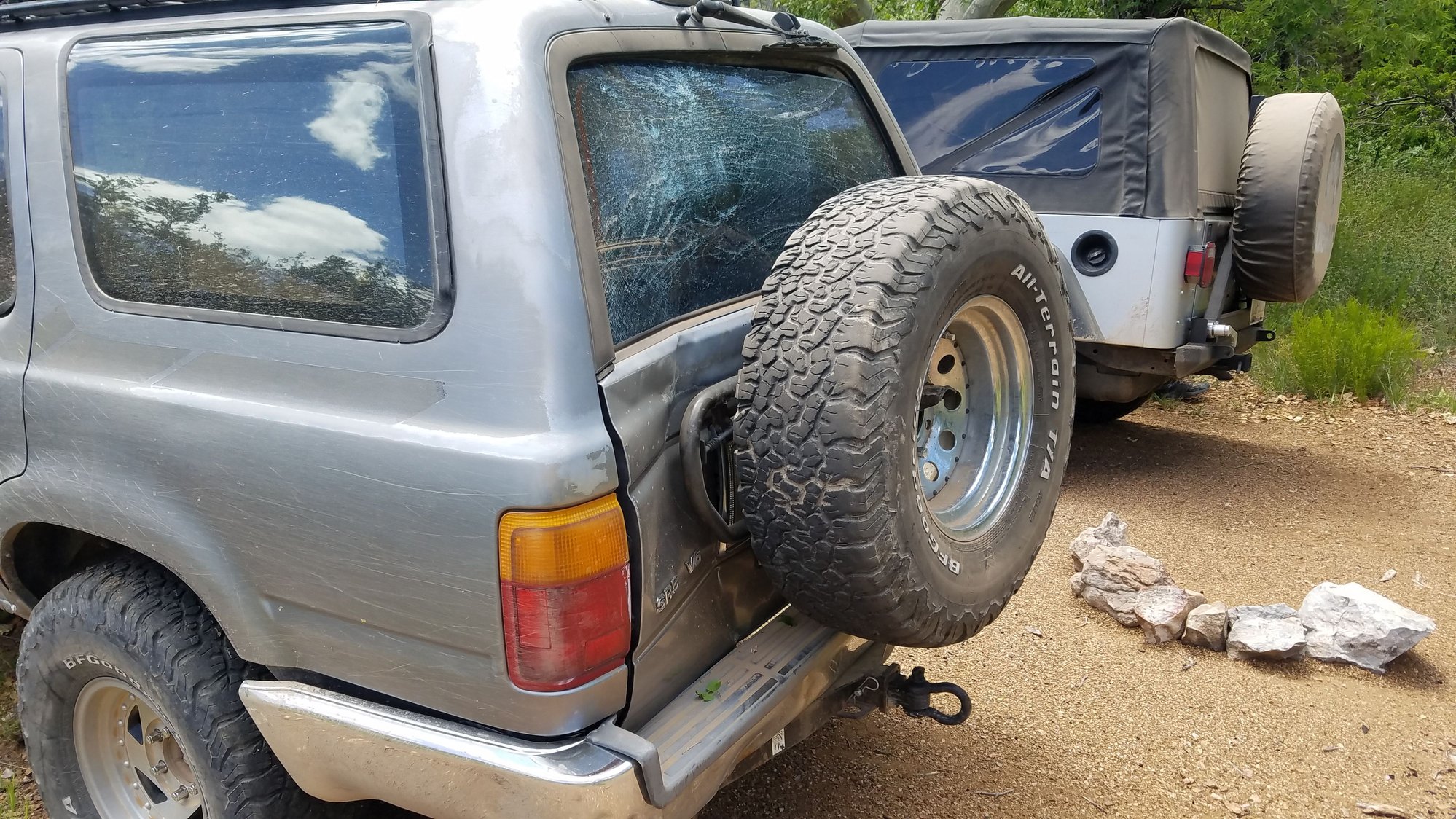

I just destroyed my tail gate on a tree this weekend. I have a replacement gate but its red. I bought some duplicolor color match paint that is pretty damn close to my runner. However, the clear coat is peeling everywhere and I have a few major dents and rust spots. I've been thinking of fixing up the dents and rust and repainting the whole truck. Now that I have to do the gate, rather than have it fresh and not match the beat look, I figure I may as well get to it.
My dilemma though, is the paint. After spraying a few practice shots on a fuel door, I really like the duplicolor paint. Problem is, it is only available in small spray cans. If Im going to do this, I will use proper spray guns. Does anybody know of any good durable paint that both closely match my paint code 196 pewter pearl and wont break the bank. Im willing to spend a few bills on paint and supplies but I don't want to spend a couple thousand. Its gonna get beat up.
I plan on doing all of the body/prep work and painting my self. It doesn't have to be perfect, it just has to be a decent 5 footer. Got any good tips for a first time painter? I plan on making a make shift paint booth from an old awning and plastic sheeting. I will do a 2 stage paint job so what is a good gloss clear? Should I use a reducer? I believe the original paint is an acrylic enamel. Is there a better paint to use like a urethane based paint like what Eastwood offers? Its gonna get scratched up so something that resist scratching is better.
