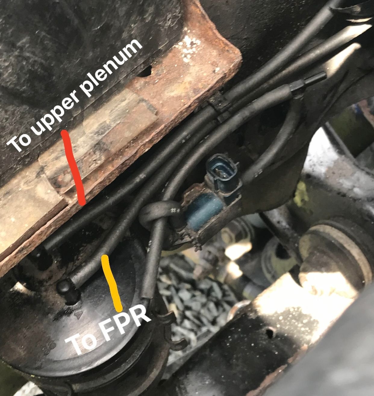

hey 4Crawlee do you have more soecifics where do the hose attach to on the left side of the plenum ? I still got my hot soak issue

Vacuum hose connects between the fitting on the fuel pressure regulator on the injector rail to a vacuum port on the side of the intake manifold. Just eliminate the vacuum switching valve (VSV) that used to sit in between those 2 connections.
ok so you just run the vaccum line all the way instead of it being intercepted by the vsv right ? What about trying a different vsv ? I found some in my spare parts

Unless your old VSV is broken, no need to try another one. I just eliminated that part on my engine over 20 years ago. It's not so much the VSV that's the problem, it's what controls it and tells it to interrupt the vacuum signal to the fuel pressure regulator (FPR) that seems to be the issue. The basic function of that vacuum line is to send manifold vacuum to the top of the FPR, high vacuum = low engine load = low fuel pressure = less fuel flowing through the injectors. Low vacuum = high engine load = high fuel pressure = more fuel flowing through the injectors. I found there were times that VSV was turning on and making the engine run way too rich at certain times.

Old Jul 9, 2023 | 11:01 AM
pimacdaddy's Avatar
Joined: Feb 2019
Posts: 96
Likes: 9
From: Vancouver Island
Before
After delete
hey 4 crawler what do you think of that

Looks like it should work, just need to get vacuum to the top of the FPR.

Yea this is where it connect to, from the botom evap I reckon its called ? To the fuel pressure reg.
about to give it a try.
So far so good tested it 3 times and didnt have the hot soak hard start low idle issue. Still got a code 5 though. Not entirely sure if I smell gasoline more now that the vsv is deleted or if it has to do with my code 5.. Thank you for all your help !
so drove a bunch and when I am back in neutral, idle will somehow have a miss at like 700 RPM ? and after maybe 20 seconds or so, perfect idle will resume and reach its 950 rpms
