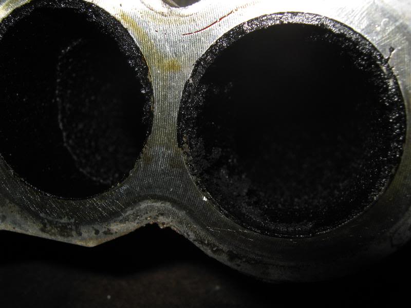

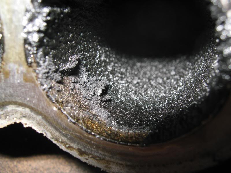

I just took off my throttle body to clean it because of a slightly sticky gas pedal and i found all this nasty blow by oil... The PO neglected the truck pretty bad and when i bought it the throttle body would only open at 1,500 RPM because it was so gummed up.
This leads to the question, should i clean this?
I already cleaned the TB and IAC, should i just pull this and do it?
I dont want to just clean what i can reach for fear of knocking something down into the valves
Heres some pics to go off

Old Apr 5, 2010 | 12:02 AM
wyoming9's Avatar
Posts: 13,381
Likes: 100
Red face
Wow I have never seen one that bad!!!
I have heard that stuff like sea foam works great and other say it doesn`t I have never used it.
Old Apr 5, 2010 | 12:26 AM
NwRunner's Avatar
Joined: Feb 2008
Posts: 453
From: Woodinville, Washington
Ive used plenty of cans of seafoam through the pcv and it obviously hasnt done much, but i ended up taking off the top half of the intake tonight.
i CANNOT get that oil out of there, its baked on. 1 giant can of carb cleaner later and im only making minimal headway... this is gunna take a while.

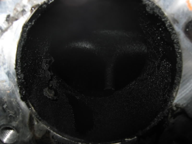

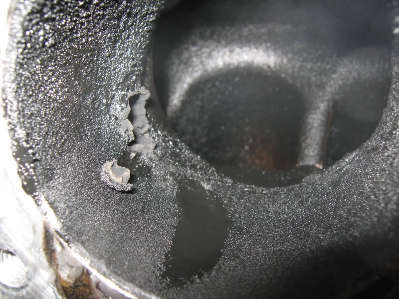

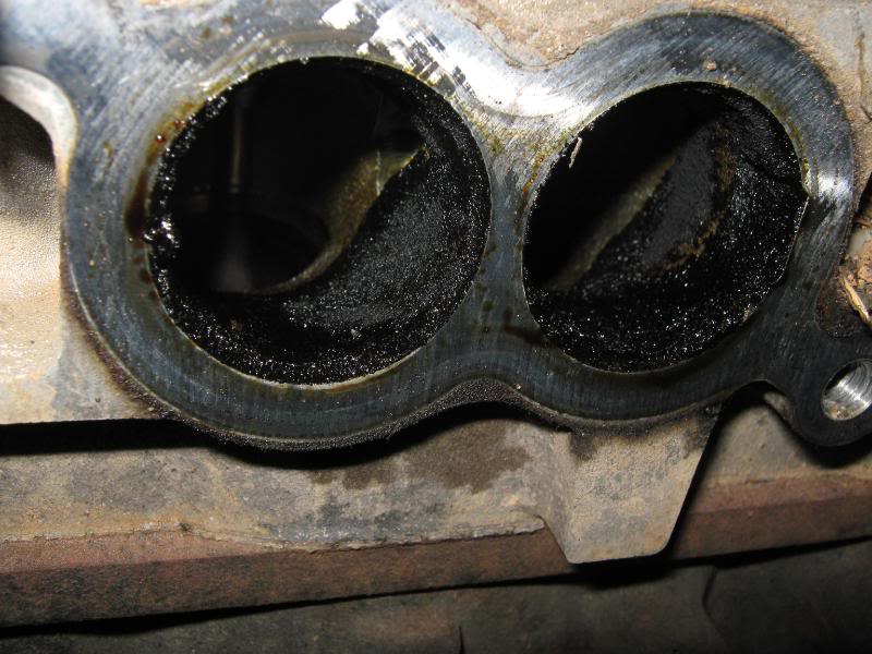

Old Apr 5, 2010 | 08:01 AM
NwRunner's Avatar
Joined: Feb 2008
Posts: 453
I got the rest of it off to peek at the valves, they look fine but the intake gets even dirtier further down. Im about to go hook up the pressurewasher and blast it out. Also a great time to change the fuel filter

Old Apr 5, 2010 | 08:03 AM
94sasyota's Avatar
Joined: Jan 2009
Posts: 129
From: Mooresville NC
let is soak in gas over night it will come clean

Old Apr 5, 2010 | 11:27 PM
yotaman85's Avatar
Joined: Feb 2008
Posts: 1,417
From: hendersonville, TN.
valve areas will stay cleaner from more heat Burning off the build up. but wow, that is the worst I have ever seen, even in motors with really high mile blowby and a stuck open PCV valve.
