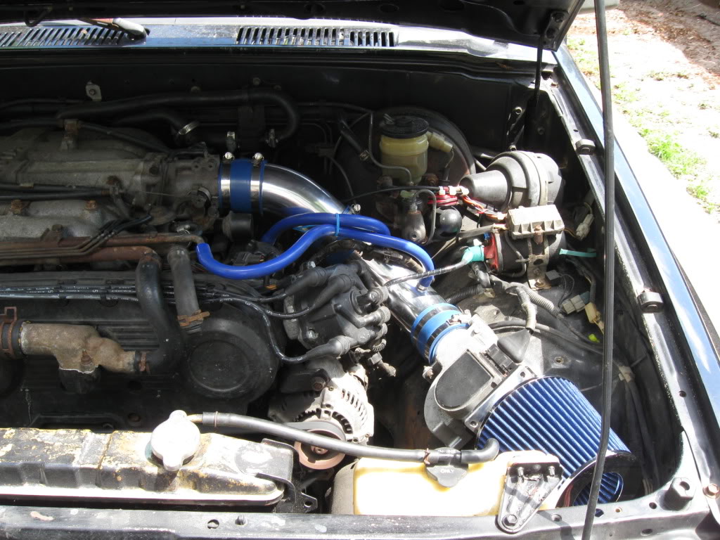

36 bucks for a cold air pipe.Thats all untill this fall when she goes under the knife.

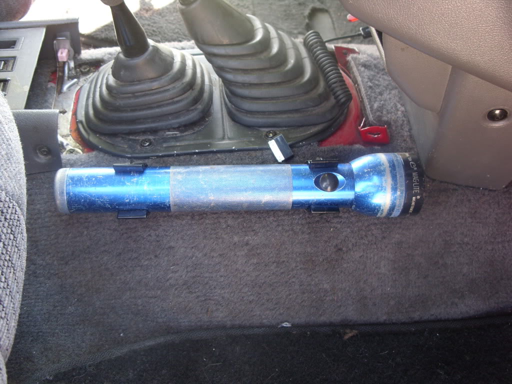

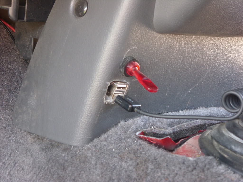

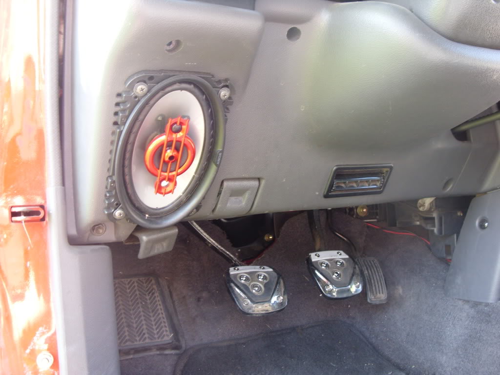

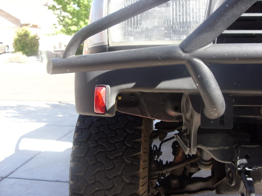

I put in some 4X6 speakers, dual USB charger ports wired directly to my aux fuse box with a switch, new LED blinker, and of course the famous Mag light mod.

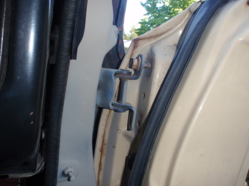

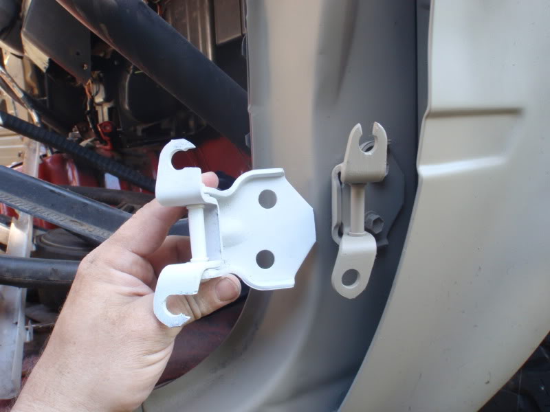

get a spare pair of hinges;
don't do the version on the left, I failed in that attempt, Mr. Stubs version on pirate works awesome take about 10 minutes to swap the doors:
old version of what I had a few years ago
Put on the tube doors over the weekend. Hardest part was getting the stock hinge pins out, have to hand it to Toyota, those things are well built..
hose clamp holding mirrors are temporary--couldn't find my small drill bits
I cut out the stock hinge pins and used some quick release, they were fine with the tube doors, but with weight of a full door on, they sagged a bit and would not always close correctly...not sure how you were planning on doing yours, but make sure the hole for the quick release pin is tight. If the brass bushing it taken out the hole is too sloppy...
If wabbit had them for a 1st Gen truck, I would go that route...

oc- on your quick-release doors, what tool do you use? can you fit a 1/4" socket back there?
