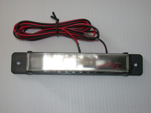

Added two of these in the canopy, $15 total:

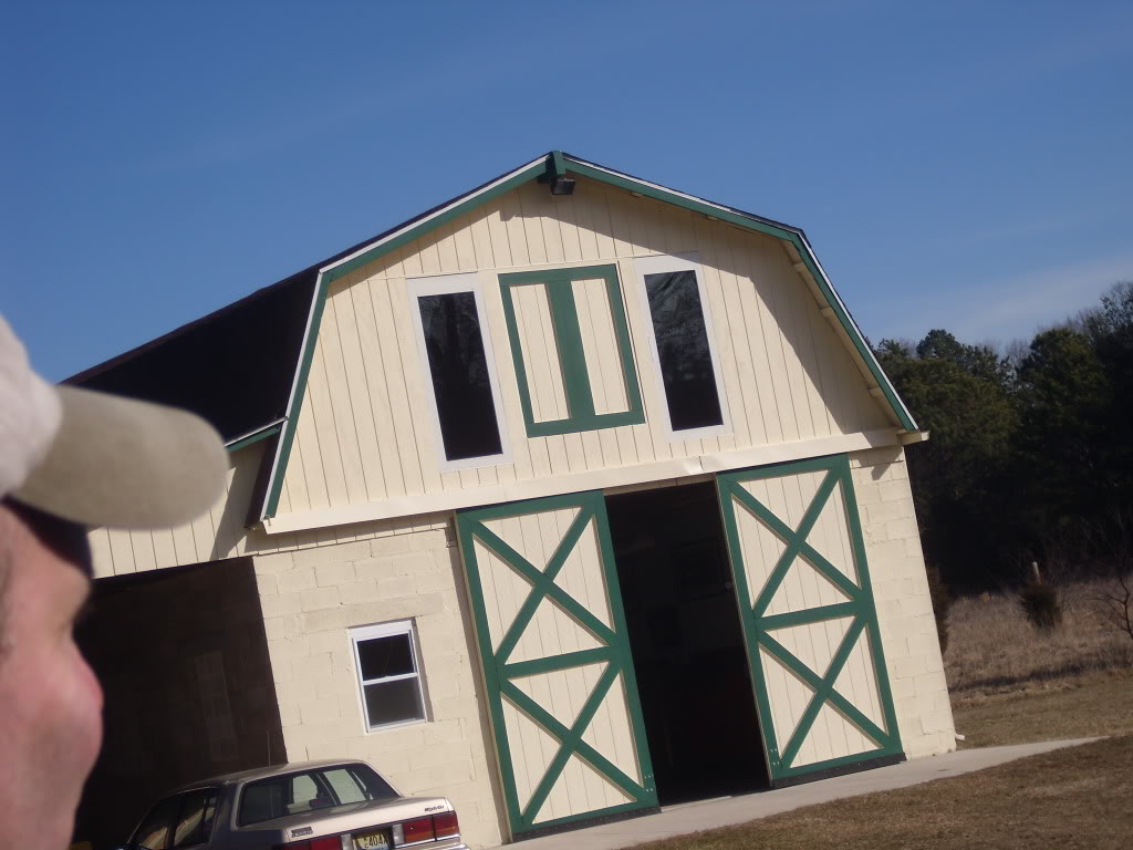

a buddy of mine used his old back door as windows on the top floor of his barn.
sorry its not vehicle related but i thought it was a good idea.

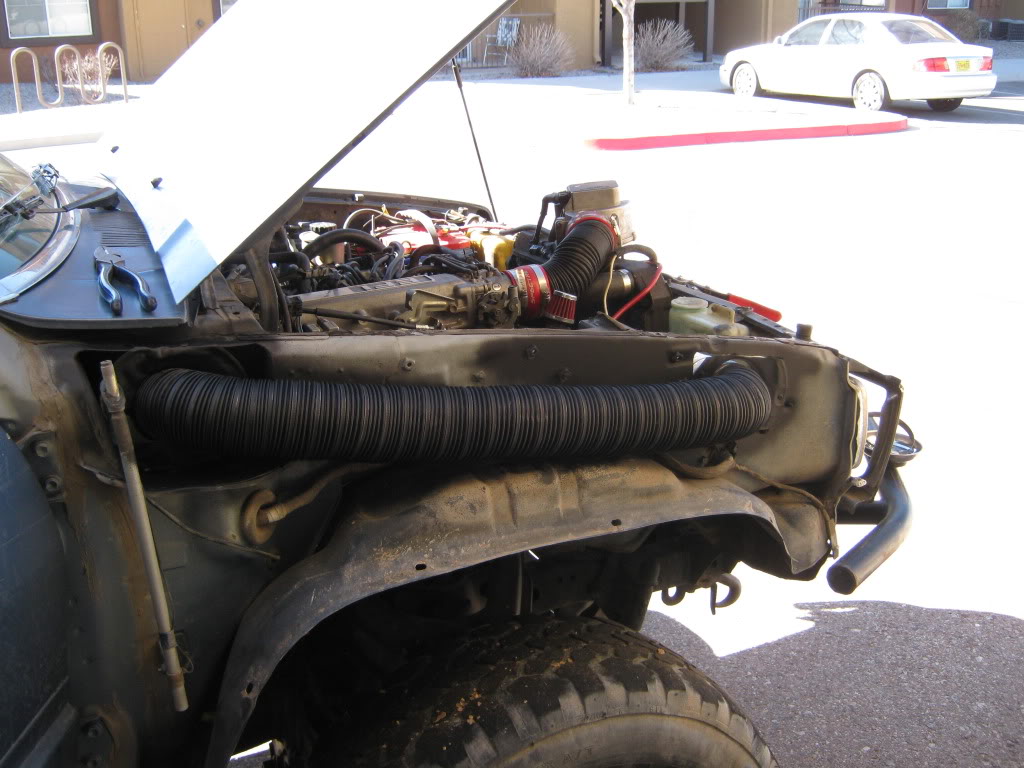

air from the cowl area

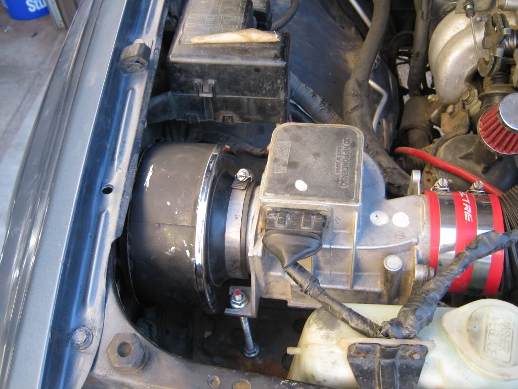

Wanted to try this for a while to see if I can get some cooler air into the intake. This is my first attempt so don't laugh too hard. It'll eventually be a snorkel.
Pulled the fender, cut some holes, and installed a 3' piece of dryer duct.
Made a semi sealed air box from a 6" ID piece of HVAC ducting.
So far I've had a minor increase in fuel millage (about 2mpg) and the throttle response seems a tad better when the truck is warmed up.
Total cost was about 15$.

nice... you wouldn't happen to have any pics of inside the cowel area, would you?

With your new intake route did you do anything to divert the water that gets into your cowl (i.e. when it rains, or at the carwash) from going into your intake pipe? Just curious.

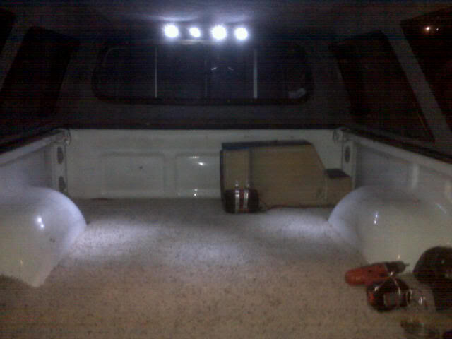

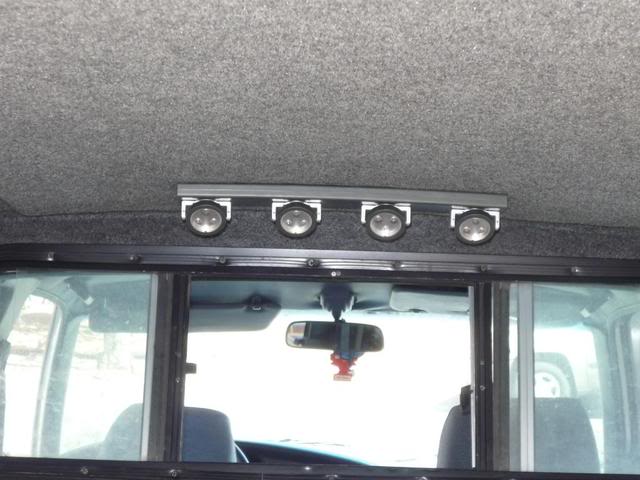

14 bucks at the old harbor store cant be beat bright led swivel mounts and they screw right and are easy to take off well worth it lights the whole bed up

are they battery powered?
