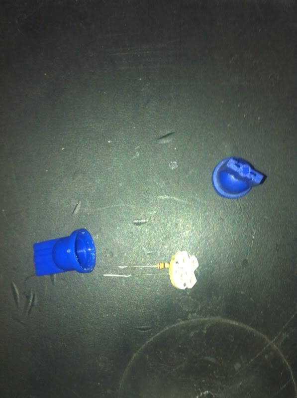

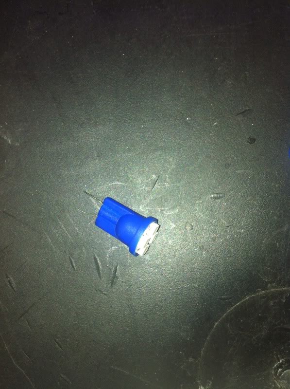

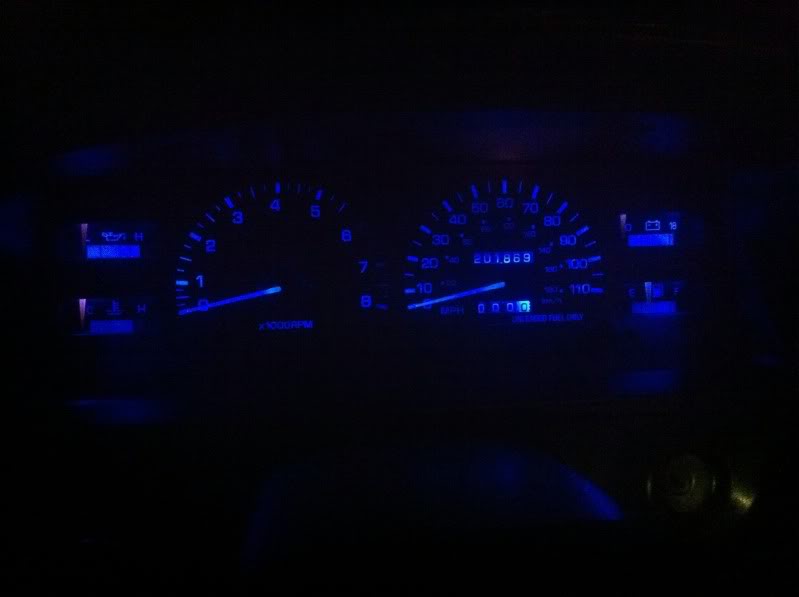

Did my $7 led gauge light conversion today. Bought the LEDs in a pack of ten off of eBay, just do a search there for T-10 LEDs. They have 4 SMD LEDs in each and there pretty dam bright. $6.99 and free shipping can't be beat.

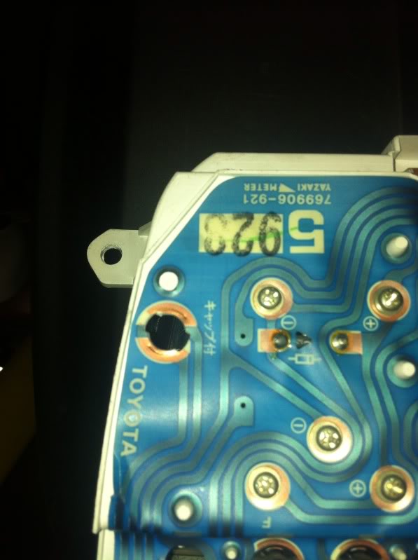

Removed gauge cluster and started installing the new LEDs in the obviouse spots. There a dirrect fit for all but the two side lights for the temp, amp, oil, and fuel gauges. These are the tinny bulbs and as far as I have researched I have not found a dirrect replacement for these. Sooooo..... I simply took apart two of the T-10 LEDs and shimied them into the small holes then bent the leads across the contact points for the stock socket. I then tested to make sure the poles wher correct befor soldering them in place.

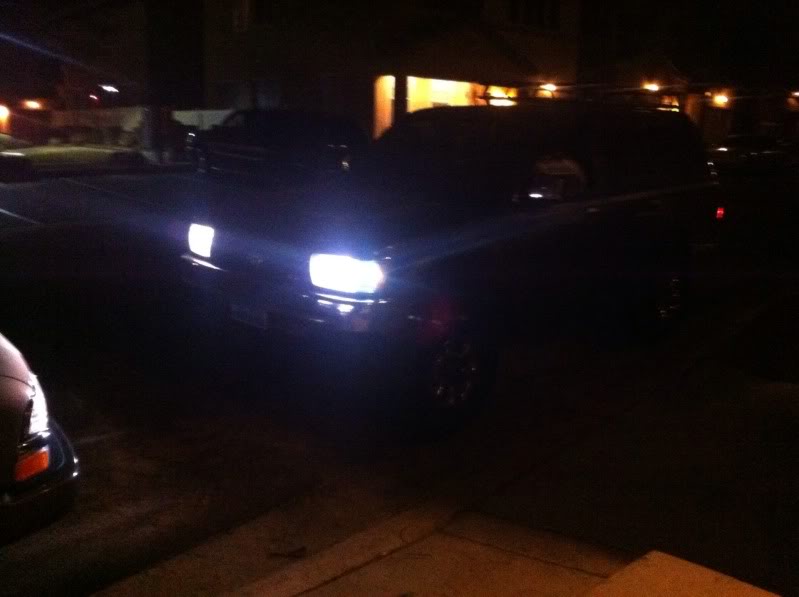

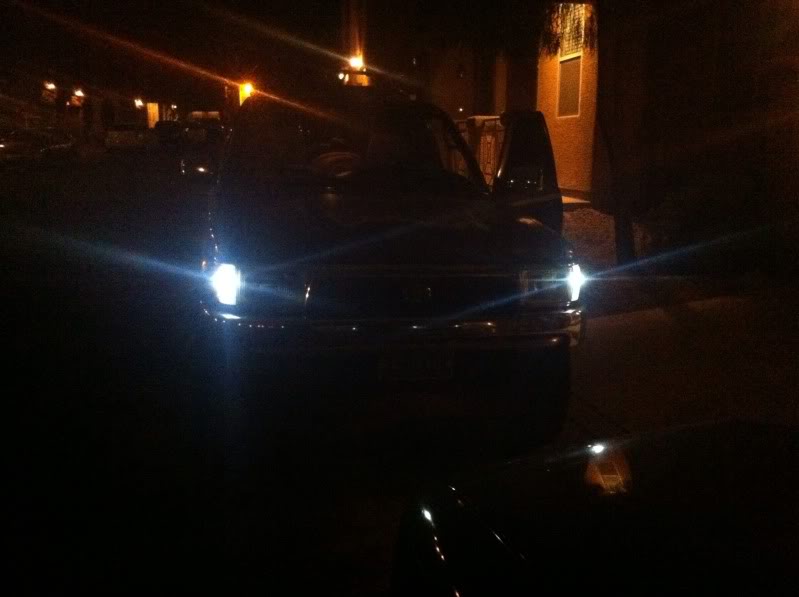

Oh and sinse I got ten of em I got a few white one for my side markers. They look realy nice with my hyper white headlights.
