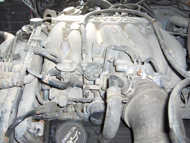

ummmm....yea...so where's my PCV valve? Getting ready to use some Seafoam
I'm stumped. I want to do the seafoam tonight, but dont want to do it wrong. I guess I could do the brake booster hose. Which is better? PCV or brake booster hose? here's a pic, someone tell me where the PCV is! I've got other ones from other angles if I'm looking in the wrong place!

or?

Old Jul 15, 2004 | 02:36 PM
  #159
Adam F's Avatar
Joined: May 2002
Posts: 2,479
From: Cincinnati Ohio
Nevermind, I found it. It's the one right below the hose that has 3 little hoses coming from it. I pulled the hose off, attached another hose to it, and sucked in some seafoam. It smoked some, but nothing crazy. I'm letting it sit right now, and I'll give it a 2nd treatment if it needs it.
