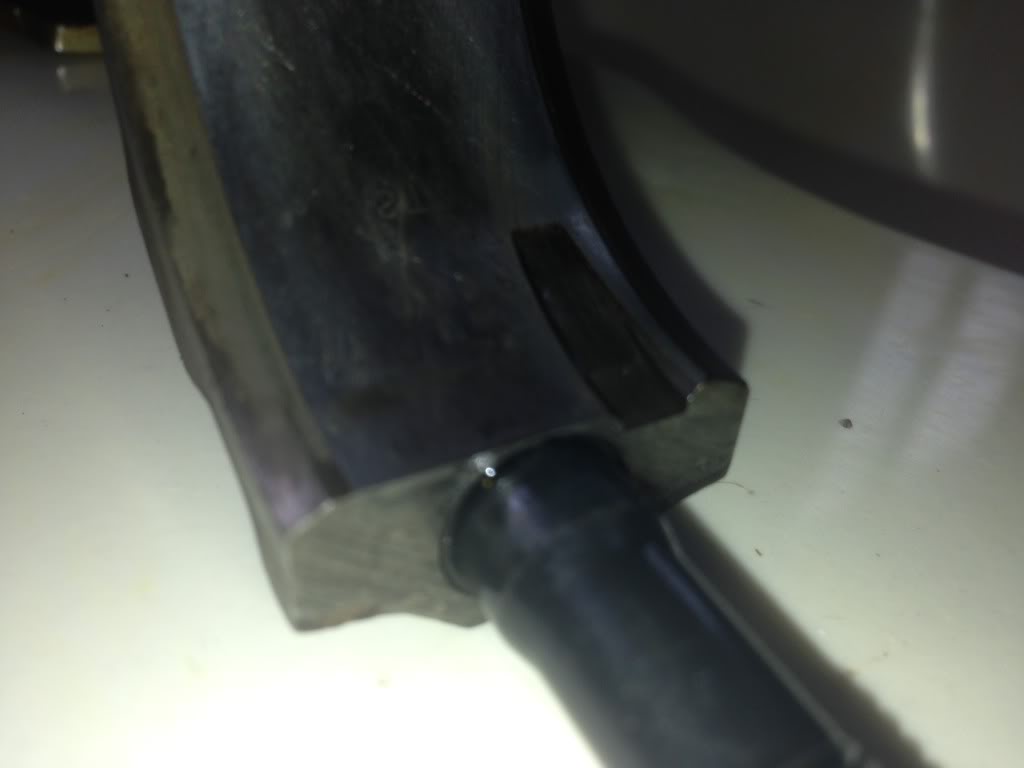

Anyone know what causes the rod caps to get this groove in them? At least 2 of the rods ends has these grooves.

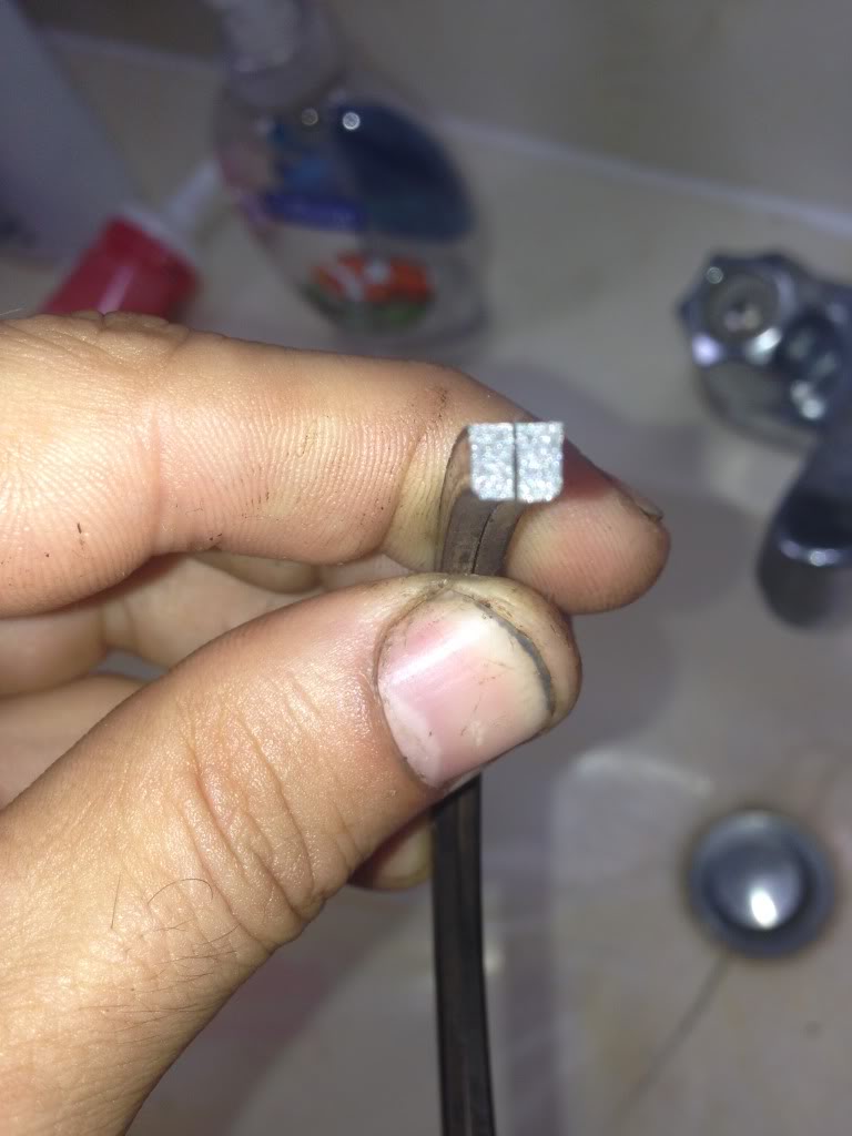

Also I took a ring that was still on one of the pistons it was the second ring down and it seemed loose in the ring channels when on the piston anyway, I pulled it off then I pulled the opening apart and it snapped pretty easy. Are these supposed to be this brittle? Here is a picture. To clarify all the top rings on all the pistons are what wee broken upon disassembly. I am thinking they broke from sitting long or hitting the ridge or combination if both but I'm no expert.

"Grooves" in the bearings caps are suppose to be there.... they are for proper cap alignment and installation.
Most piston rings are made of "plated" cast iron which is very hard however very brittle.
There are some piston rings made from steel and or steel/iron plated in chrome.
