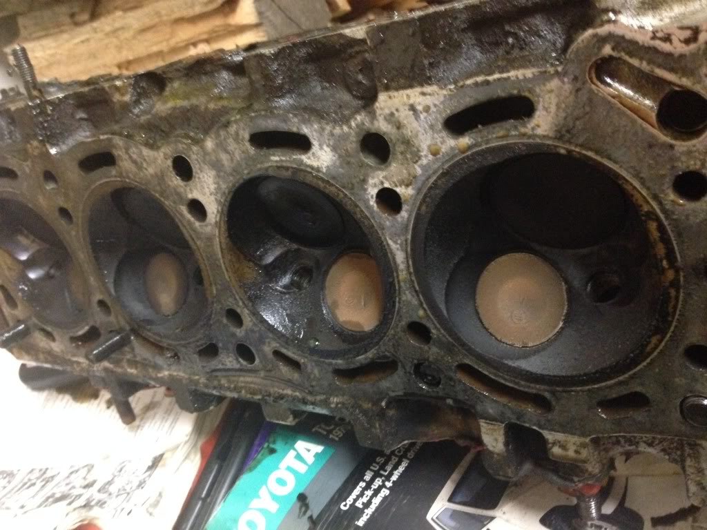

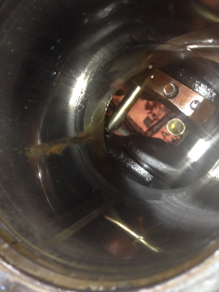

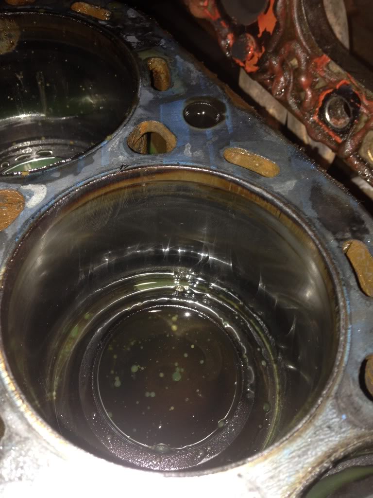

So I took the head off. Here is some pictures. The stamp on top of the pistons read 1.00mm I believe or 100mm but I think it's 1.00mm which would be .040 over if I'm correct. No cross hatching on walls. Supposed to be only 10-15k on the bottom rebuild. Hmmmm. Well I dunno what I'm doing yet. Still need to drop the oil pan and pull the pistons. Also I added a tablespoon of oil to cylinder 2 before I pulled head and did another compression check and it bumped it up to 150 and held on the gauge. Name:  null_zpsc051e149.jpg

Hmm.. looks like someone did a simple re-build without re-conditioning the cylinders.
I would pull the pistons and have the cylinder block measured/checked/machined.
Verify pistons and rings are correct for the cylinder bore.

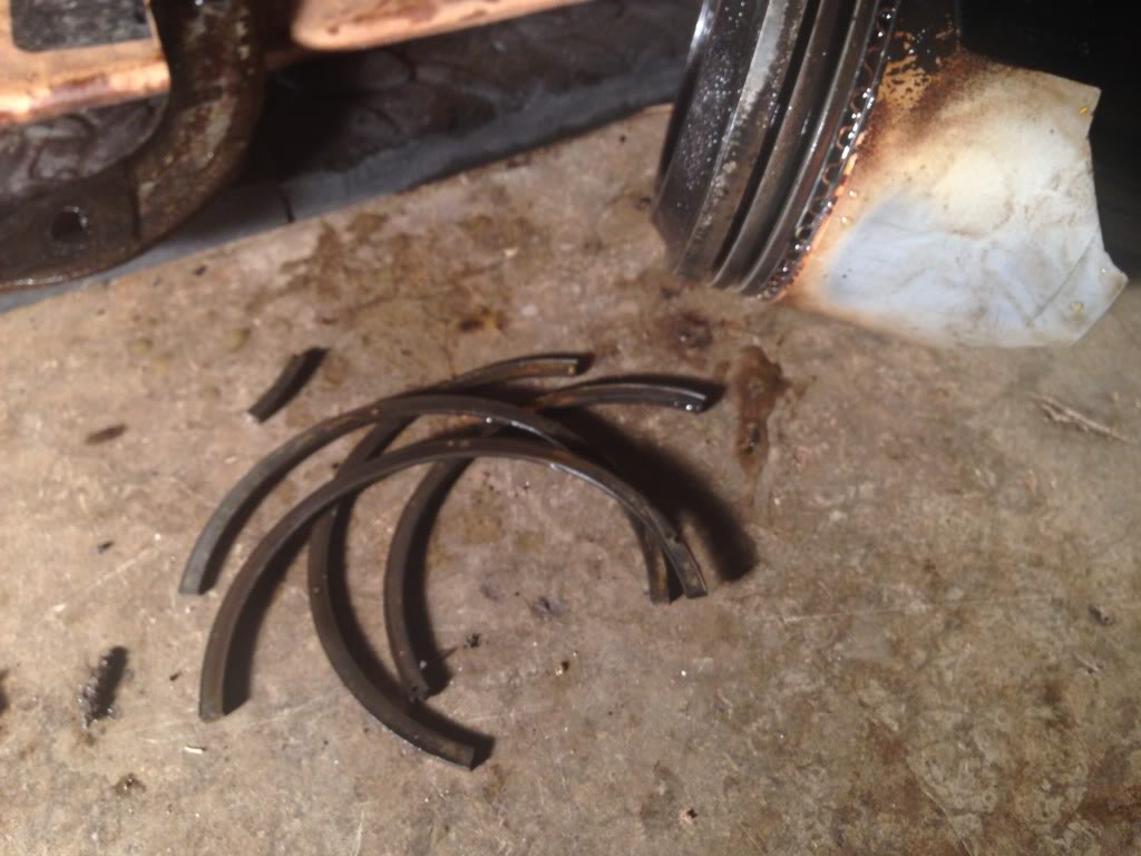

This is piston #2 from the low compression cylinder. Broken rings.

Old Oct 1, 2013 | 06:17 PM

That sucks for you man. I bet if you had done Terry's trick first, you wouldn't of broken the rings.

Just pulled all the other pistons and everyone has broken rings.

>_<...
Feel your pain. Good luck on repairs.
At least you found your problem.
