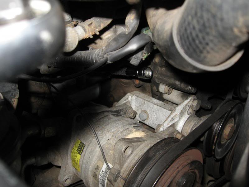

Well, I ignored the problem till it got too irritating... and so last weekend I replaced the starter. Why the whole thing? If one part is getting warn out, I figure the whole thing is soon to follow, and BOY am I glad I did. That baby was in ROUGH shape.

You could take the new starter, shake it, and hear no movement. Shaking the old starter was like a rattle... the bearings and things in there were TOTALLY shot, and there was end play in the gear portion. (here I will point out that the truck starts up better than a new vehicle now. Its amazing how much better it is!)

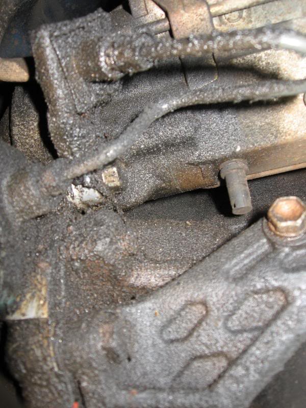

Bottom bolt was easy... and Yikes at all the build up down here...

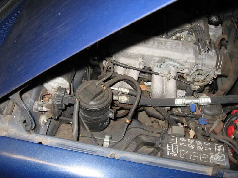

Top bolt was supposedly a MASSIVE pain to get to... but after looking at the truck I saw this
Almost right in the middle of the screen, I circled the starter top bolt in red

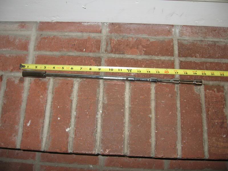

A little searching the house for extensions...

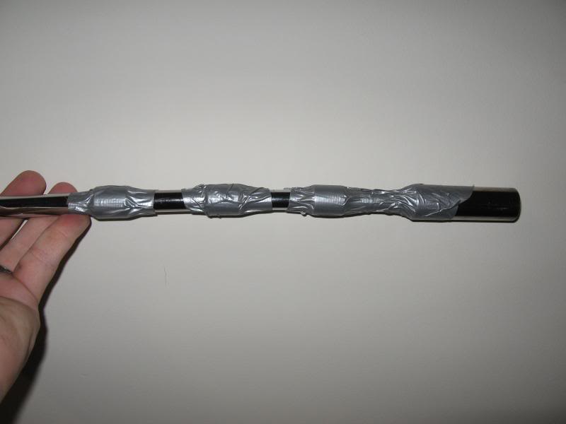

Pro-tip: this is how you keep extensions from falling apart while you work!

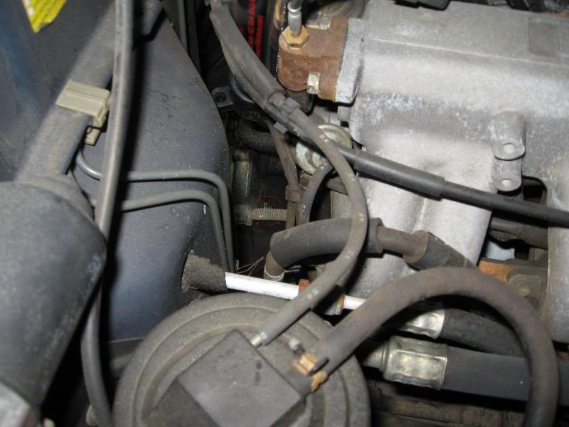

And, once you snake it through under the intake manifold, you end up w this
Starter came out in like... 10 minutes max. Getting it back in was a TOTAL pain though, as I had to support it with part of my hand... while my hands were trying to get a bolt to thread. NO fun working without a jack doing this! lol.
