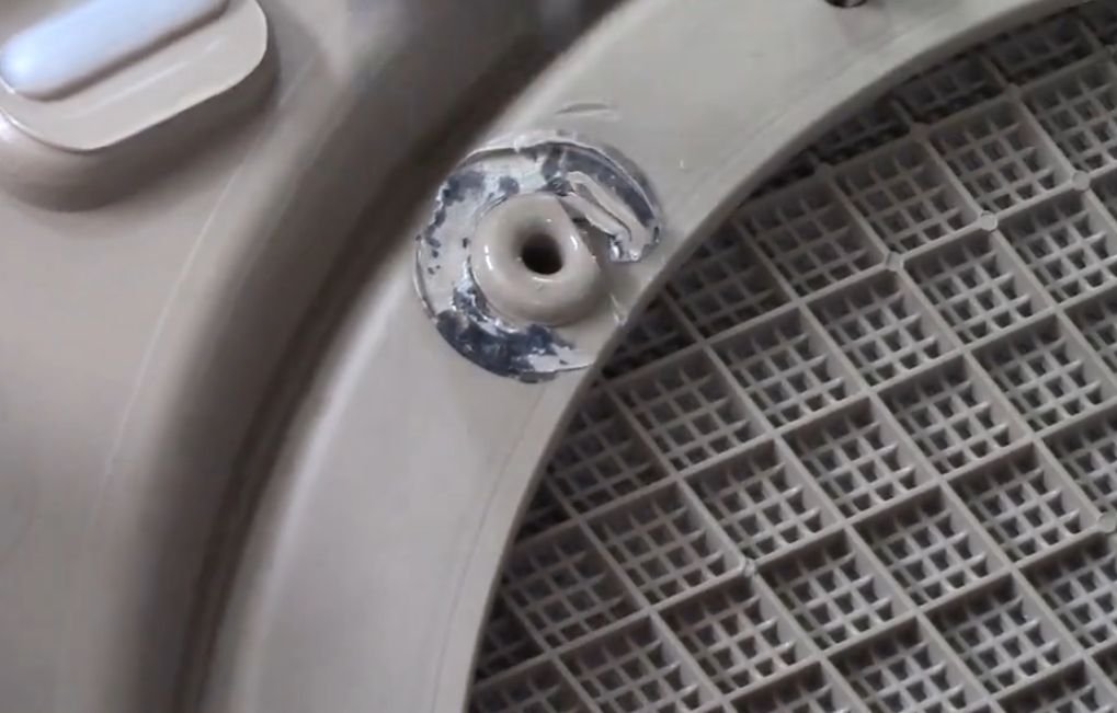

I am looking at replacing the material on inside of doors, getting dirty and ungluiing from panel. I removed the panel and on the backside there is what looks like plastic rivets holding the pieces together. Is there a way to remove these and then how do i put them back on. They look like melted plastic done from factory.

Was asking about these types of plastic rivets that hold the upholstered part of the door interior

This looks promising and makes sense:
You could also use an epoxy to re-create the original plastic rivet if you wanted but some correct length screws should work depending on how deep the hole is.

That looks like it would work, i would be afraid with the age the plastic might crack putting screws in. But i could always heat up screw first and kind of melt its way i. making threads. Thanks
