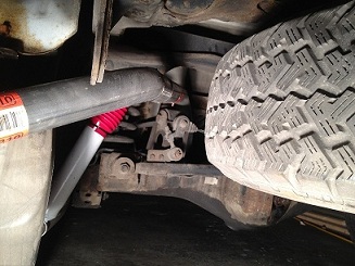

Here's the issue: I took my truck to a local shop that builds super truck rigs, dune buggies etc. because they gave me a deal on a used muffler in good condition with heavy 2 1/4" tube on the tail pipe. I decided to let them install it since, I don't have the skill to weld. What I ended up with was a 2" tail pipe that runs over part of the back suspension with less than 1" of clearance, as shown in the picture below.
Does that look like an unacceptable amount of clearance?
They never asked me about reducing the tail pipe diameter, just said the old one wouldn't fit, I agreed they should put a new one together, and they fabbed up a new 2" tail pipe with two 90 degree bends. When I asked them about the reduced tail pipe diameter, they said it wouldn't affect performance, would you agree? It's an old stock engine.

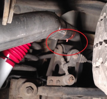

Here's a close-up of the area that concerns me.

Should be a higher up bend right over the axle. So, yes, the tail pipe is improperly installed.
I wouldn't worry about the diameter. 2" is fine.

My question is does it hit anything as the suspension works??
If it is not banging and clanging it should be ok.
I can`t see why they didn`t put more of a bend over the rear axle though.

Ya it contacts, I can hear it going over speed bumps. The suspension has about 1.5" travel before it starts to contact the rubber stopper/bumps in the back. I was originally supposed to get a used tailpipe that sort of kinda worked, but instead they fabbed this one out of new dynomax bends and it basically ended up the same.
