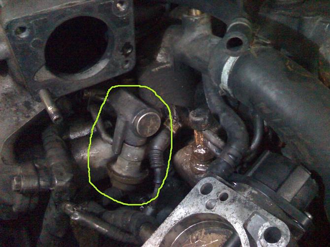

Is this the iac valve???

Old Aug 12, 2009 | 01:44 PM

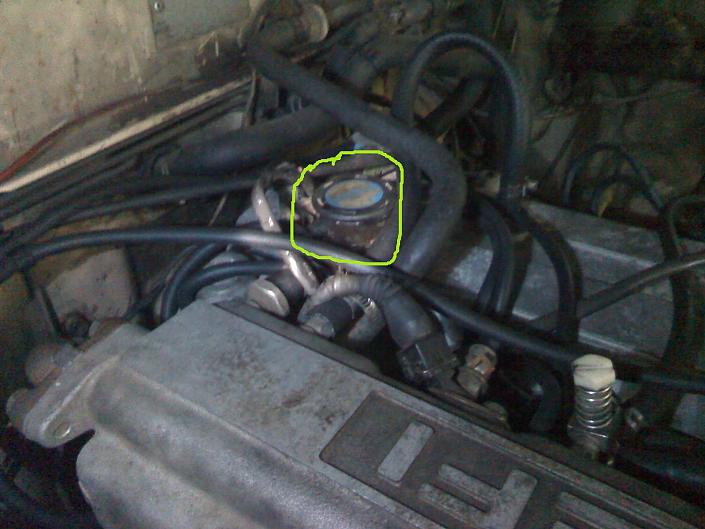

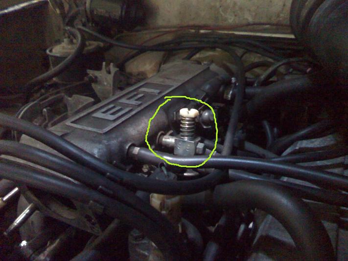

also....does anyone know what these 2 things are??? i'm thinkin the one that's got the lil white screw on top that's connected to the intake manifold has somethin to do with some vacuum adjustment...anyone know???

Old Aug 12, 2009 | 03:03 PM
Lumpy's Avatar
Joined: Jan 2009
Posts: 6,086
Likes: 17
Well I think the white screw thingy is for the AC idle up...If i'm not mistaken.

well if that's so it won't bother nothin...i have no ac at all lol
and i figured out what the other thing is (but Correct me if i'm wrong)...it's an EGR vacuum modulator....think it has somethin to do with makin sure the engine burns all the fuel or somthin like that.
