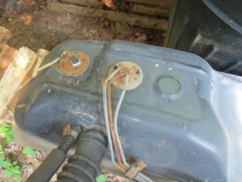

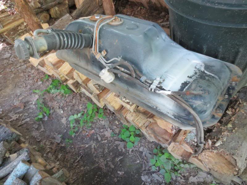

So in the spirit of preparation for some free time; does anyone have any advice on cleaning and sealing a gas tank? I haven't found any real info on hear so i figure i will give something back to the community and try to document how i end up doing it, if it works
The tank on my truck has a slow leak so i bought a replacement that does not appear to leak(it came full of gas) but i want to get it to where i won't have to worry about it for a long time.
I have a vague idea of how to seal it but no idea as to how to prep it for sealing. So if anyone could enlighten me that would be awesome.
Once i clean it i plan to coat it inside with Red Kote: http://damonq.com/red-kote.html
Not sure on the outside yet.

I had a leak on one of my land rover's fuel tanks. Since replacement tanks are hard to find, my dad and I decided to have it welded, but the leaks were in a really hard to reach spot.
We ended up using the Por-15 tank sealer. It has been 5 years and we don't have any leaks from that tank. I'd give it a go if you're in need of a solid repair.

I have done several. I soak it in white vinegar for a few days and then rinse with a high pressure hose and coat it with Red Kote. Works great and havent had a problem on any of the ones I have done.

It looks like that tank came out of a carbed truck??going by the plastic fuel filter.
Do you know for sure??
Which means when you open it up your going to find you need a new fuel pump bracket along with a fuel pump.
If you have the 22REC listed
Tell me more. I have the 22-RE. All i know about this tank is that it came out of a 93 long bed 2wd. Would the bracket from my current tank not fit? And i was going to replace the fuel pump anyway.

Usually a 2 wheel tank is smaller or was when I did a frame swap. I am more comfortable in the 84-89 years. Been awhile since I worked on 89-95. That tank is for a carbed, the fuel pump assembly wont go thru the opening.
4Runner and trucks are not interchangeable on the 84-88 and probably the same for the next generation. The fuel and vapor lines are oppisite and is the quickest way I identify them.
Thanks for the compliments on my builds. I eventually get them on the road.lol
copied
Also the tank on the left is for a fuel injected truck.Bigger opening to allow for the fuel pump to fit in. The tank on the right is carbed and it may not show in picture is but is smaller. This tank came off of a 2wd truck.
