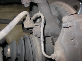

finally got pics
Okay so I finally got pics of my brake line. Is this the speed sensor that is connected to the back of my rotor which then goes to the brake line? Here are a few angles. The line coming from the back of the rotor is metal and is stiff with no play. Is this different from yours? Do I need to disconnect this line from my rotor, because I cant hang the rotor with it on, being that it is solid stiff.

little bigger pics
trying to figure out this picture thing. sorry for the repost, hope these are better.
Attached Thumbnails Brake pad replace-brakeline1smal.jpg   Brake pad replace-brakelinetopnew.jpg   Brake pad replace-frontviewsmall.jpg

That is not a speed sensor; brake fluid flows from the rubber hose into a metal line, then into the caliper.
Take this bolt off- this bolt holds the plate that the rubber brake hose and hard metal brake line are joined at.
Once you remove this bolt, you will be able to move the caliper because of the flexibility of the rubber hose. Removal of that bolt will allow both the rubber hose and metal line to move away from the spindle and be secured with a bungee cord or rope.

Just a note as to how I do it. At the point that the rubber hose joins the hard metal line, it goes through a bracket to hold it in place. The hose is held to the bracket with a big slide clip. I pop the clip out and the hard metal line will move in the bracket so I can turn the caliper however I need without bending the hard metal line. When putting it back together, I just slip the clip back in place.
