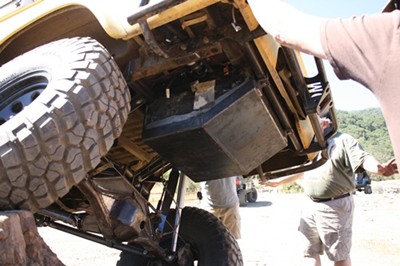

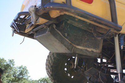

If you limited with your small stock fuel tank here is a sweet option. I was up at SillyFab in Sacramento, CA and saw a fuel tank that was removed from a early Bronco. It holds 23 gallon! Phill @ SillyFab added a skid plate to the bottom side and now it is in my Toyota. Took it out this weekend and everything worked great.

Pretty cool idea, but not digging the loss of ground clearance. Would work well on a desert truck though.

It has plenty of ground clearance. The pictures make it look like it hangs low because I had the rear tire jacket up on a large tree stump and we took the picture looking up. I have nearly 29" from the ground to the bottom of the lowest part of the tank. That was/is higher than the stock tank in the stock location. Sometime picture can be miss leading!

I figured as much, it looks as if it's sitting above the top of the rear diff,, I can just imagine though coming down off a ridge and smacking the tank off something, but then again that's what the skid is for.

Last year I got hung up on a large rock that filled the area under the bed between the diff and rear bumper. Now I'll just slide right down the back side of the rocks.

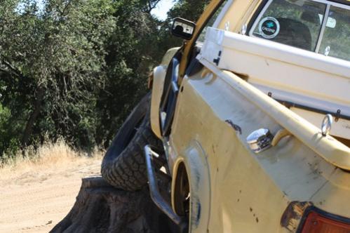

The fuel filler needed to be relocated to the drivers side. I picked up a flip cap used on may buggies. You can see the location in this picture.

I moved the fuel filler to the drivers side of the bed near the tail light.
