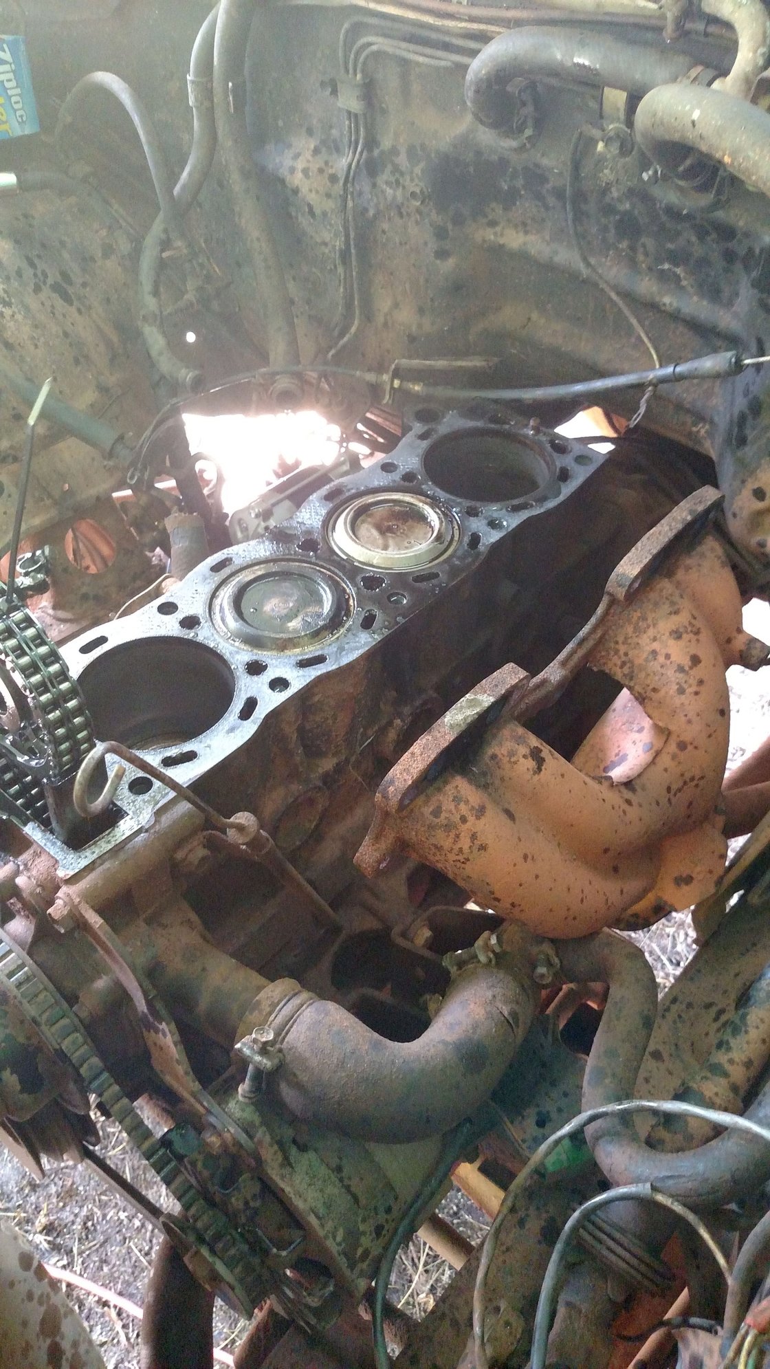

And here is today's project: my brother has water in his oil, oil in his water, and smoke in his exhaust. Very bad.
