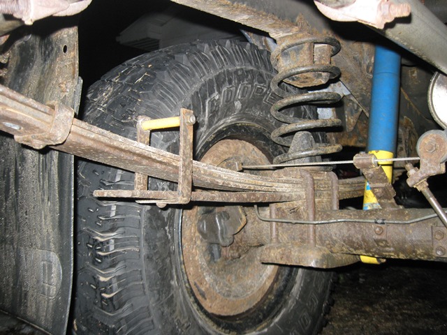

I ordered the '97? - '06? jeep coils from a dismantler. I cut a bit off one end and still have a little rake. Hear a little 'thong' once in a while where I guess the round coil rubs the square bump. Can't get you a picture right away.

Pic is of Just your average zuk mod, no weight in back. Coil assists tired leafs. Great for me as I stuff 4runner full of firewood and still don't flatten out leafs all the way. Not flexy though.

Man, I gotta do this. I have a case of saggy butt. Looking at the pic, was a no cut version? I think it'll be the next thing I do. Getting saggy enough, I think it's screwing with my caster. Leaves are about flat unloaded, will give me a reason to twist torsion bars a little, too.
