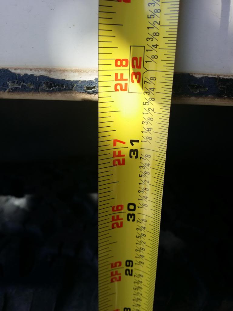

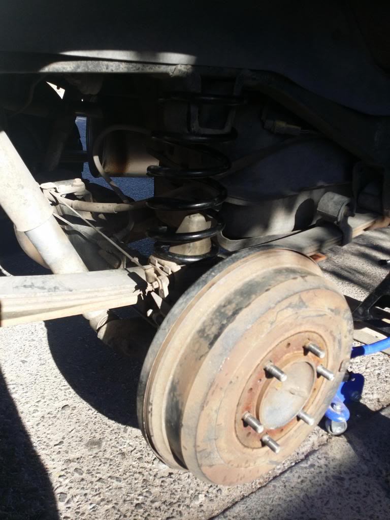

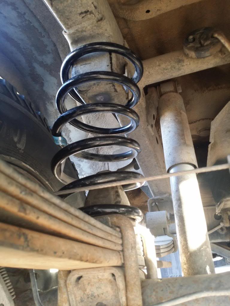

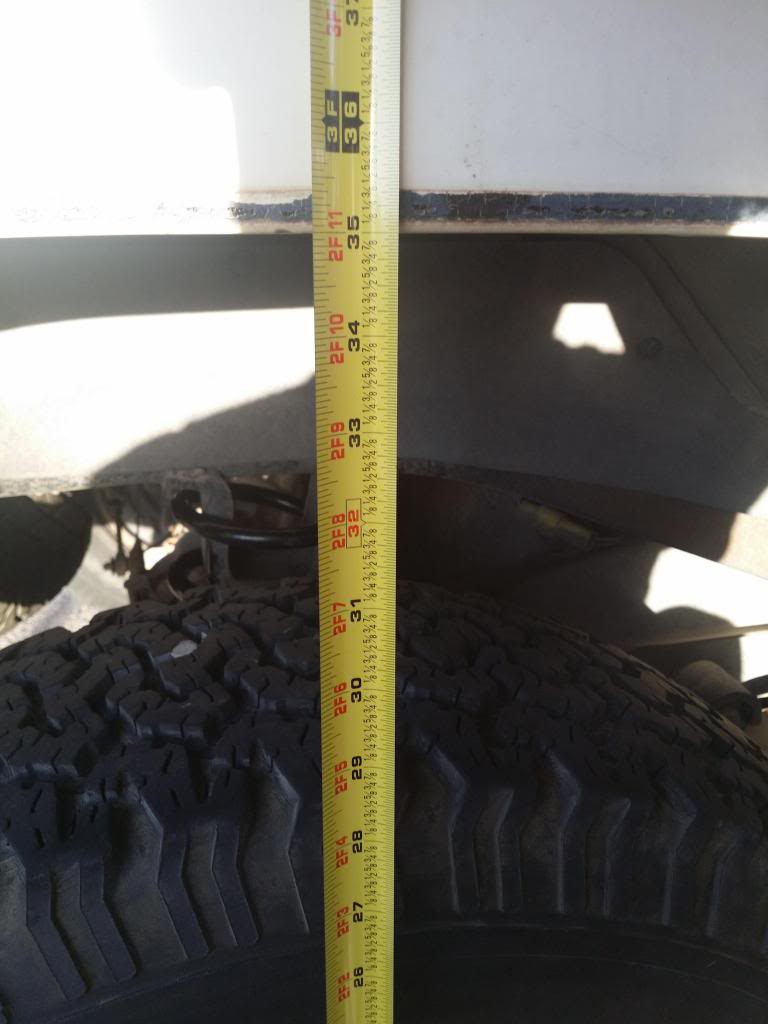

Ok so after about 2 hours of fighting with these springs, its finally done! I started at 31 3/4 inches from the floor to 35 inches even after, adding 3.25 inches.

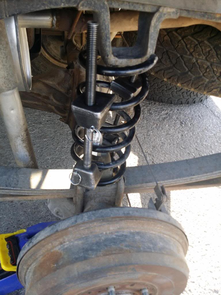

I went ahead and added the front jeep springs instead and cut them at 13 inches from the original 18 inches, the rear are 14 inches but just didn't like the way they narrow on side and cutting the would have cause me to just open them too much that and I didn't have a torch to open those instead as someone else here did.

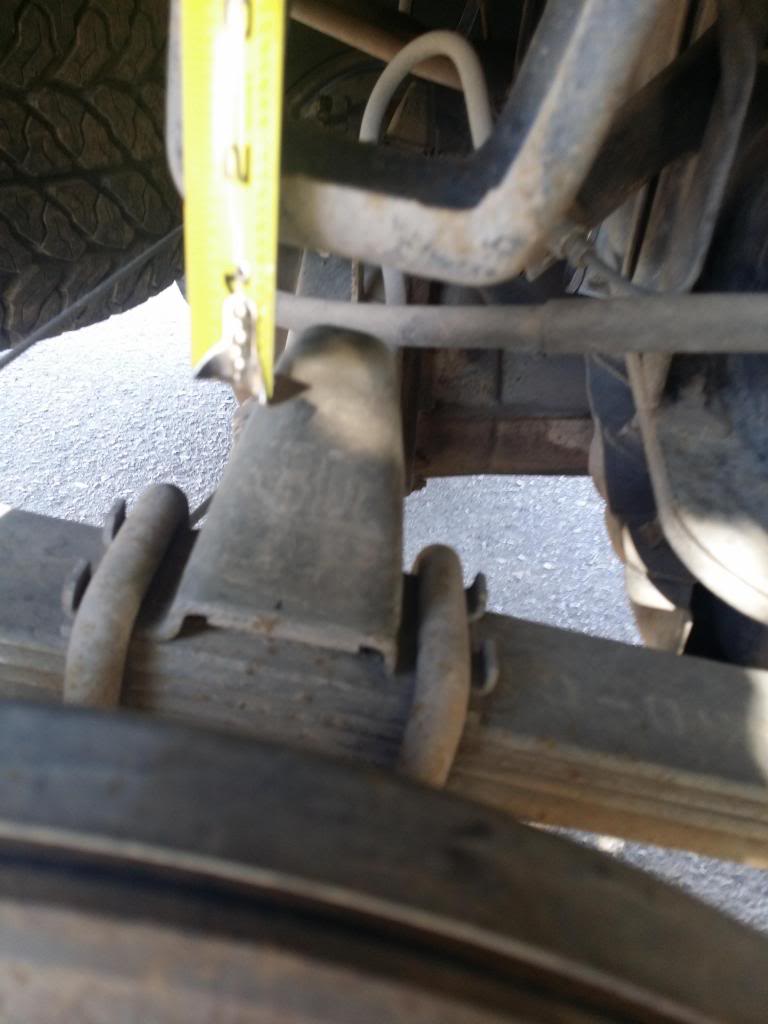

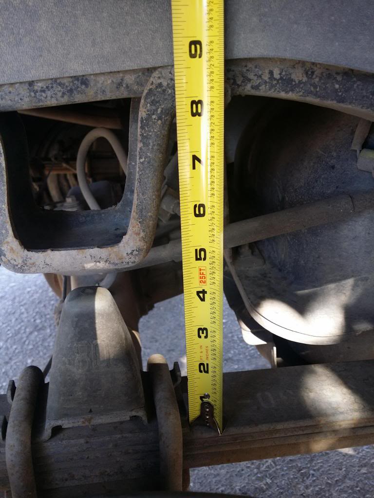

the space between my bump and bump stop was only about 1.5 inches!!!

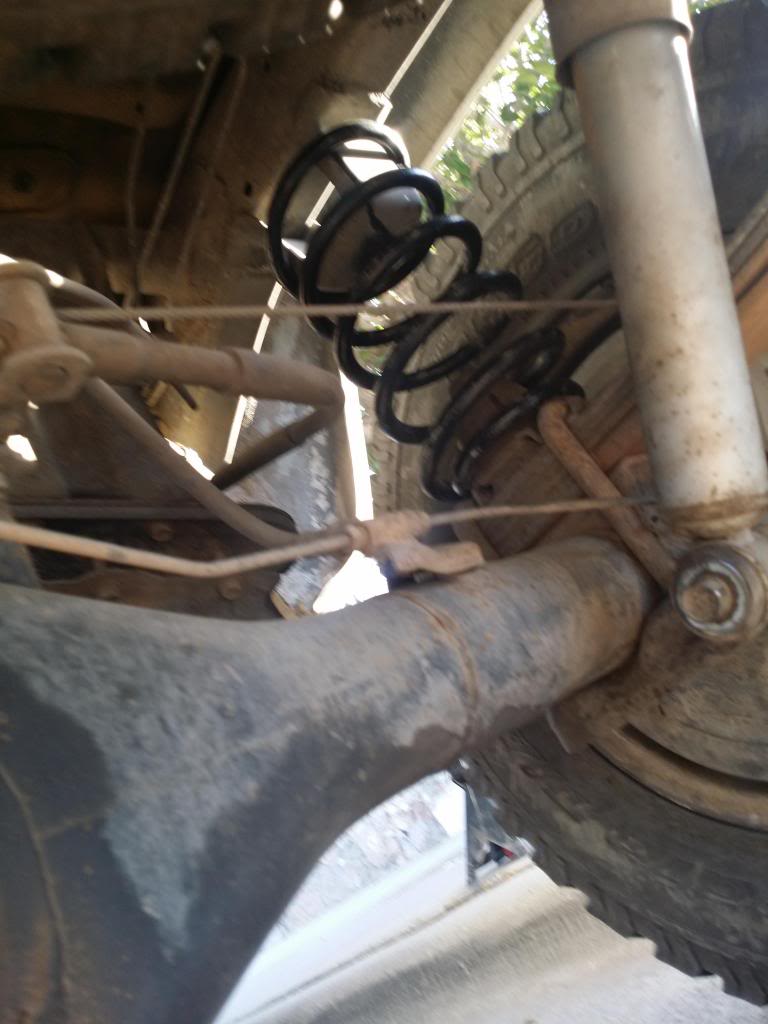

I took a grinder with a metal cutting wheel to cut the springs and used a spring compressor to fit the springs. I did remove the rear shocks to get extra clearance and used the factory jack to jack the leaf spring from the frame to get even more room.
No more jumping out of my seat on bumpy roads! Overall easy, you just gotta be careful with what youre doing. highly recommend!

initial measurement off the ground:
bump stop measurements:

What model jeep did those springs come from? Looks good man.
Old Jun 1, 2014 | 07:00 PM
martinezoi's Avatar
Joined: Apr 2014
Posts: 60
From: El Paso, TX

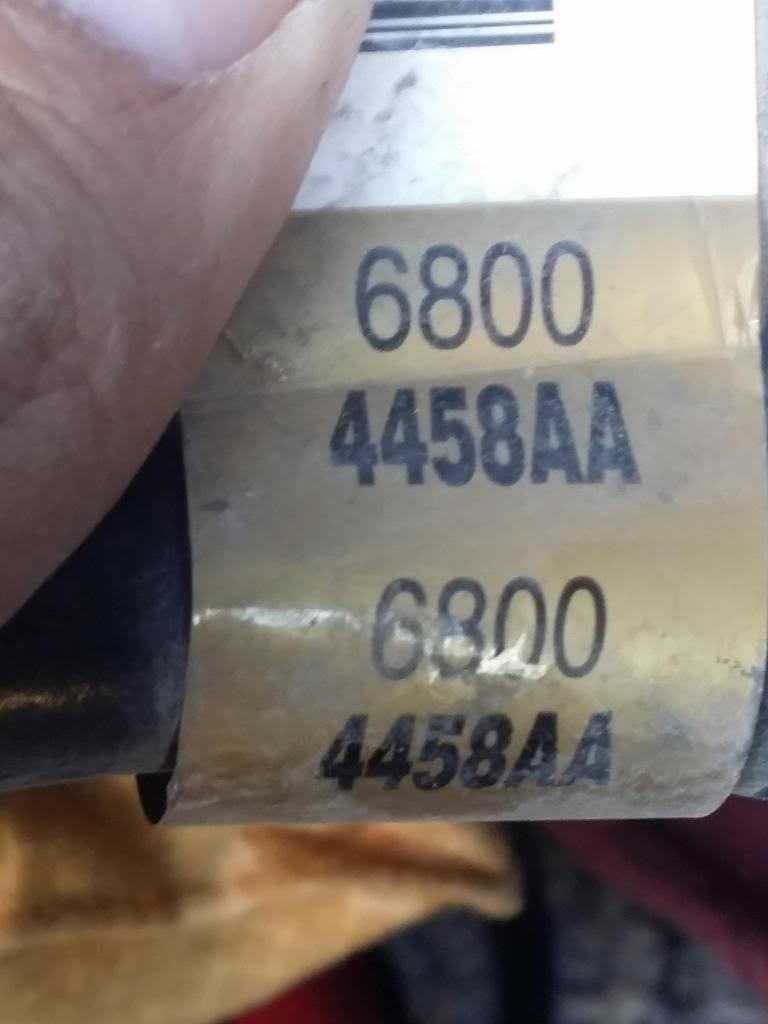

they came off a 2010 jeep wrangler rubicon. got them for free a buddy at work that had them laying around. I do have the part number in case you want it
Yeah, I do. my rig has a case of saggybuttitus.

p/n's fronts 6800 4458AA,
Nice! 3.25 inches added and no noticeable rake?
nah, the rear was really low before. It just leveled up to the front, I didn't even adjust the torsion bars.
