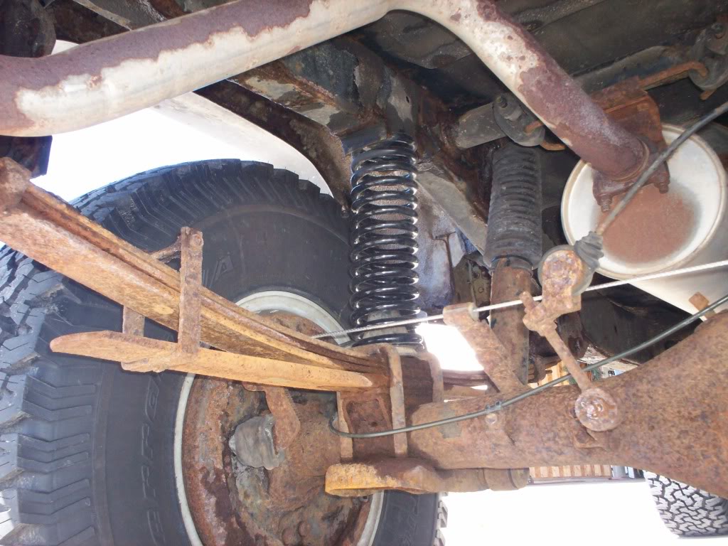

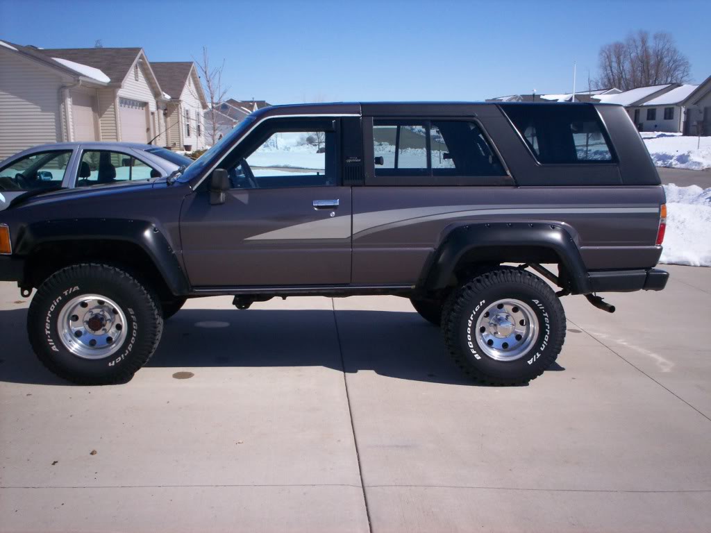

O.K ZUK, i was waiting until i could get some descent pics to post.To start out with ,the springs were sitting flat on the overloads and my bumpstops were missing!!,made a nice racket when you hit a big bump,basically frame on frame.sooooo, ,jacked up the truck to put jack stands under the rear end and took off the wheels, then put the jack under the hitch and raised the rear of the truck enough to take the weight off,then used a bottle jack in between the leaf spring and the frame and spread it apart enough to be able set the coil spring (125# 14")on my lower bump stop and from the inside of the frame,another little tip i just remembered,my bottle jack wasnt quite high enough,so i used the upper (metal) bump stop i had cut off as a spacer on top of the leaf spring to set the jack on...if that makes sense.
i used a long huge screwdriver to pop the spring into the purch that i made out of the upper bracket.when you cut it short the spring really fits great . i actually EASILY popped it in with a hammer.i also did about two turns on my TBs . heres some pics of before and after.
BEFORE
AFTER
Ive been driving it for about two weeks now and am amazed at what a difference. Im debating on weather to even bother with the BJ spacers?!
heres a couple pics of the springs

Looks good! I especially like the fender flares.

Nice cman1.....It sounds like it took alot to get the coil to pop in place....drop the wheel as far as it would go....bottle jack to stretch the leafs down even lower....and a BMF screwdriver. I guess that means that you have a better chance of finding ice in hell than a coil on the ground.
By the way, what's all that brownish red stuff on the axle housing/muffler/leafpacks?

Looks awesome...what a difference. Great decision going with the coils instead of AAL.

You have a lot of rust on everything. The frame is probably getting thinner by the hour. The cool thing about the coil is it now transfers a large part of the leafpack load to a stronger thicker part of the frame farther from the actual end of the frame. So now, the end shackles are not straining the hell out of the frame.
Looks like you have a solid 4 inch lift now. I like the rake look and don't see the need for BJ spacers. Others would want them.
