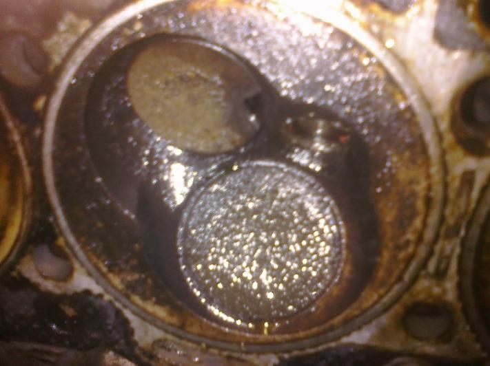

I purchased a very clean 86 4runner, but the clown that owned it before me totally screwed up putting the #2 plug in and did even worse putting a helicoil in. That caused a lot of detonation which broke a piece of the valve off that luckily just exited right through the exhaust.
I decided to put a brand new head on it, but I am having trouble with the vacuum. I pretty much have it figured out, but the one I am having trouble with is right on the throttle body, just under the TPS. It is a larger hose, and cant figure out where it goes. Any help would be greatly appreciated. BTW I searched and my eyes hurt from looking at so many pictures, lol.
I will put up some pics of the truck and the head job when it is completed.
Here is a picture of the valve that broke.
