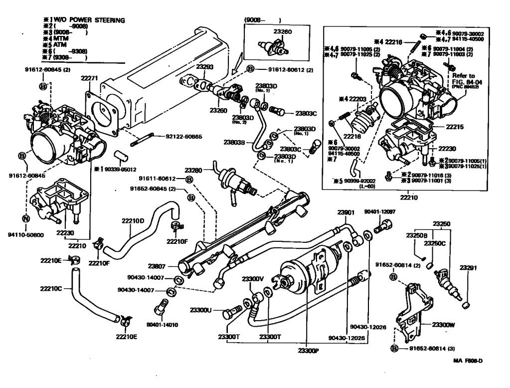

Hi, i recently picked up an 89 toyota with a 22RE. It had idle problems and start up problems. I found the problem...both screws for the TPS are missing. No part stores around here can look up the size of screw i need. If any one on here can either pull on of theirs out and measure it or knows the correct size, it would be greatly appreciated. Thank you

pick em up from a dealer: it's one of these two or 1 of each. Diagram isn't clear:
90079-11003 or 90079-11004
SCREW, W/WASHER 90079-11003 1 $0.71
SCREW, W/WASHER 90079-11004 1 $0.62

thanks for the photo and link. helped out a lot. now time for the fun part...setting it

x2 on the 4crawler link, thats where i got the measurement for mine 4mm x 16mm

Does anybody know what the hose 22210D is or where I can buy one

Does anybody know what the hose 22210D is or where I can buy one?
What year?
it circulates water/coolant through the throttle body and idle air control valve to adjust engine rpm’s depending on engine temp
