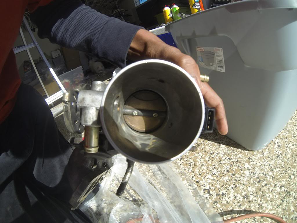

heres a pic of the TPS in the original spot (see how its open a lil Name:  GOPR1335_zps00363d79.jpg

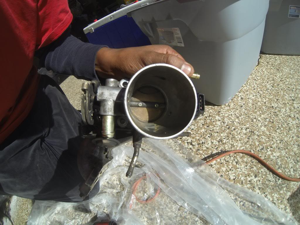

and on this pic u can see its closed just about all the way but the holes dont line up

Your TPS looks WAY off in the second picture. It looks angled up too much. Are you sure you have the fingers on the side of the throttle body lined up with the fingers on the TPS correctly?

yeah its seated right ill go double check.Is my TB suppose to look that closed

If I remember correctly it is otherwise your idle set screw wouldn't do anything for you. Back off the throttle stop screw until it's free and then tighten it down until it touches the plate. Then give it another quarter turn and lock it down. That should have your throttle stop set correctly. That TPS still looks way off to me tho.

so i think i got it on correctly gonna install now wish me luck

fixed the problem thankz
