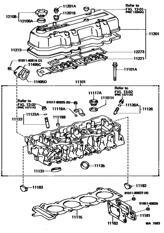

So i just had my valves adjusted, and a few days after i see oil leaking at the back of the engine. My first suspicion was the vc gasket wasn't installed correctly. But after looking more closely, it appears it's leaking from a plate at the back of the head. The official name for the gasket is rear head gasket and it was only $14 at Toyota and they had it on the shelf.
is this a common fail point? They quoted $480 to replace it so I'm going back to the shop that did my valve adj hoping they'll cut me a break on labor.
I was going to wait until the next oil change service, but i don't like leak drips on my driveway, plus it seems like i hear the valves sounding louder on startup and I'm becoming paranoid it's not oiling up the head well because of this leak.
Anyone familiar with this repair have any input? I appreciate any insight offered.
Truck has been purring. Has been a while since it was nice to drive it.
In this image it's part 11182. The part # is 11182-35050.

11182 does not seal against oil, because there isn't any oil behind it, unless there is a serious crack in the head or something.
you are probably leaking along the top line of gasket 11183, which is the half-moon... that should have been replaced with the valve cover gasket, when the valves were adjusted.
take it down to the car wash and blow off that entire back area, including spraying upwards at the back of the head from the fender well... then start it up and feel for oil leakage around the half-moon area, you may have to drive it a short distance.
i remember going thru the same hassle of trying to figure out that same leak area, it sucks.

worst case, if you can get the back seam of the valve cover joint sopping wet with cleaner, and completely degrease the area, you might try wadding a big hunk of rtv all over the area... i've had that work with leaky rear main seals on engines.
replacing the seal and half-moons every time that the valve cover comes off is the way to go.
