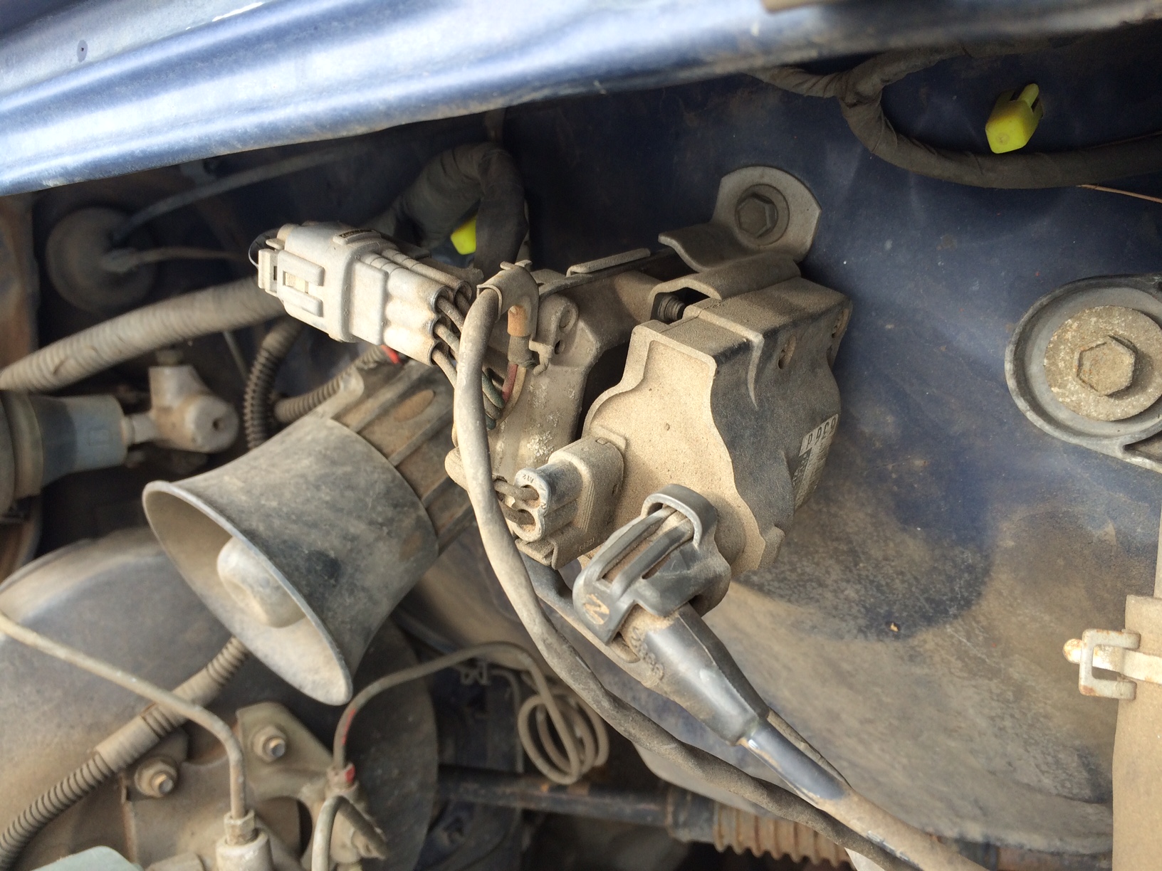

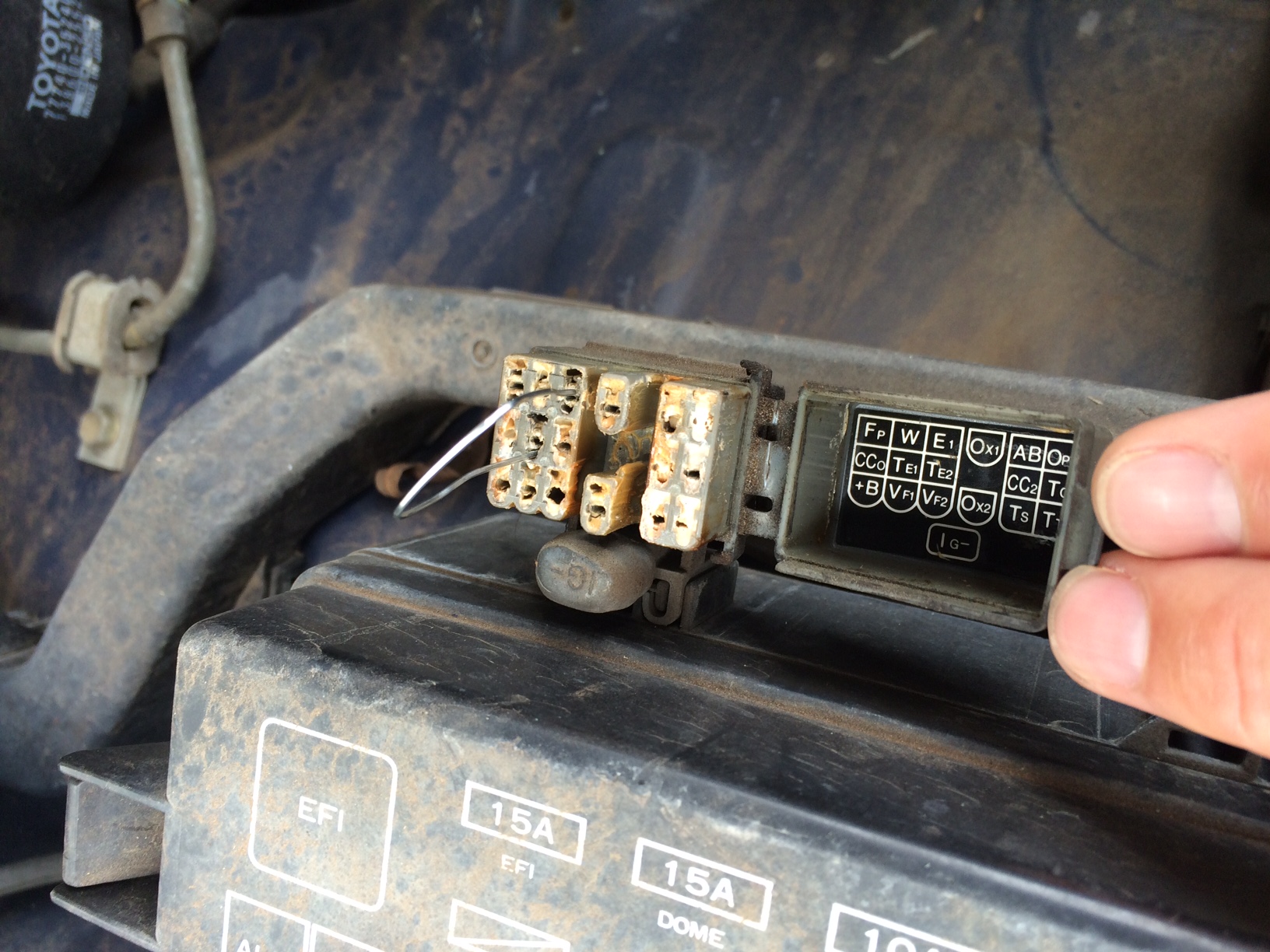

Update 2: pulled the codes (see pic below for setup) and the sequence is - I I I I I I I (~1s) I (~3s) I I I I I I I (~1s) I (~3s)...repeating = ODB1 code of 71 which is -

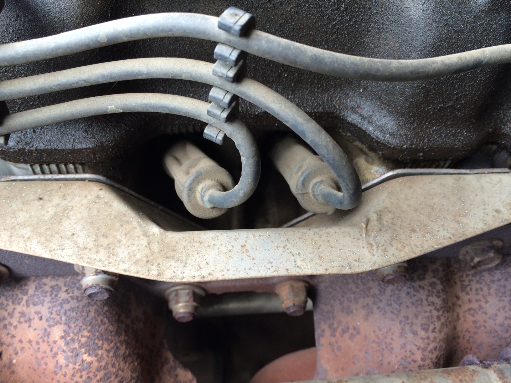

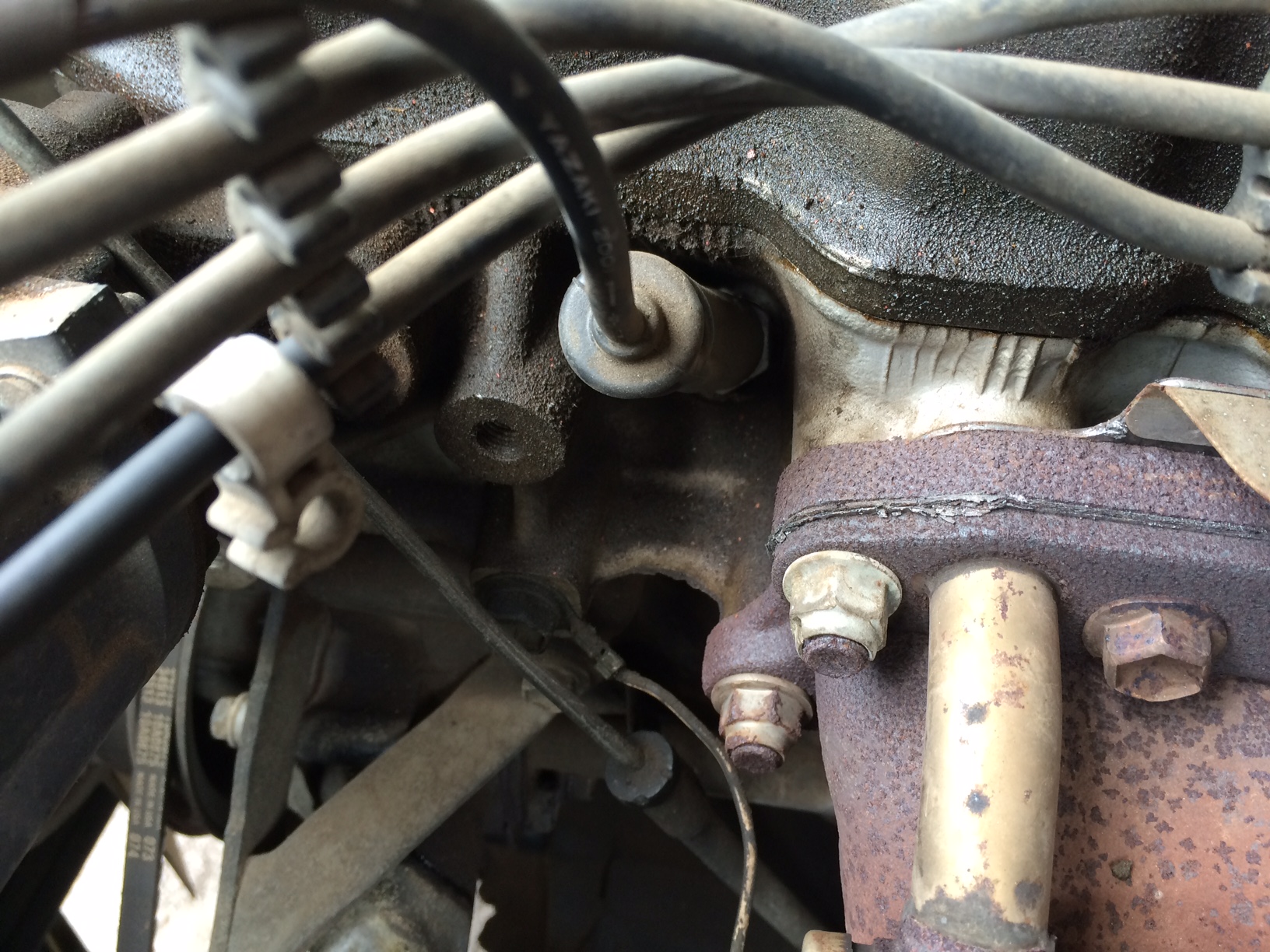

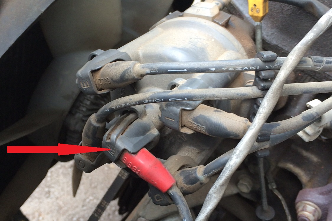

Update 3: Added pics to this thread of the diagnostic setup and distributor cap, plugs/wires and ignition switch.
Update 4: Added pic with red arrow to mark where the shock originated from .

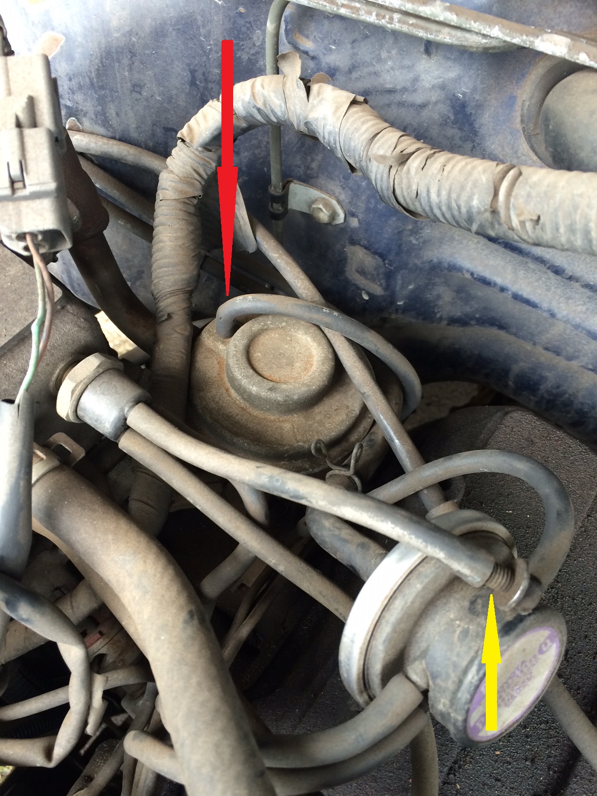

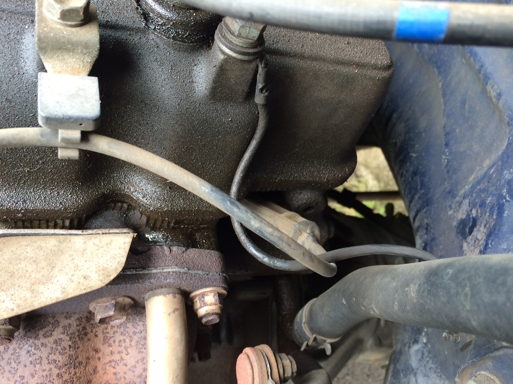

I took a pic to confirm the right hose on the EGR. The red arrow is pointing to the correct EGR hose/port yes? I have access to 1/4" and 1/2" rubber tubing I hope this works. I also found a hose that has a bolt plug and it has a yellow arrow. Any idea what this is? Odd!

not sure where that loose hose goes, but that's the right egr hose.

I disconnected the EGR hose you specified and connected a ~2ft. section of vacuum hose. Plugged the original hose and sucked through the 2ft section as you suggested which caused the engine to nearly die. What does this tell me?

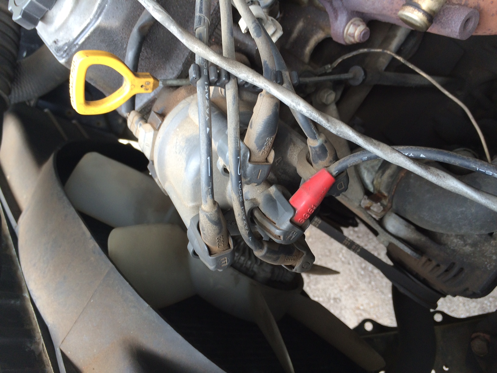

Your coil wire is not pushed all the way into the cap!!
In fact that is a different coil wire .
By now it must have been arcing enough that the wire and the cap have some damage
That is the reason you got your little tickle !!
When was the last tune up ??
Yikes! I attached a picture. So I assume the cable lead needs to be seated in line with the other cable leads on the dist cap? That looks waayyy off. What did you mean that it looks like a different coil wire? It is not the OEM wire kit that the truck had installed? I called the Yota dealership parts dept. today and asked for a quote, the Yota cables are ~$105. I can get them in by the weekend as they have to be shipped from Honolulu. If you think there may be damage to the cap/rotor how can I check this? Can I check without screwing up the timing? I also had my yota parts guy quote out the distributor cap, rotor and plugs just in case so I can get all the parts no worries. I've owned this pickup for a little over a year and I do all the work myself (except the tires which I don't have the equipment for) and have not had a tune up yet. If possible I'll do it myself. Nice catch and good eye. Thank you!!!!! Love this forum...
i think that the stalling is caused by the presence of exhaust gas in the intake? it's important because it tells you that the egr valve itself is probably working o.k., in other words not totally clogged up.
if you follow the hose back to its source at the front of the engine(?) i think that it starts out hooked up to a metal tube that in turn hooks up to a valve that operates on temperature? to put it another way, there are things that control when the egr is supposed to pass gas.
i think that if you disconnect both ends of that valve, you should be able to blow thru it when the engine is hot, but not when it's cold??? there is also a vacuum modulator, see the location pics for both here: https://www.yotatech.com/forums/f116...w-pics-159248/
it'll be similar to this: http://www.pirate4x4.com/forum/toyot...placement.html
need to dig up more troubleshooting steps on this, but what you've done so far is good news.

Just pull the wire out of the cap look if the end of the wire and cap are arced (burnt)
Not knowing just what wire that coil wire is it should be pushed in as far as the other wires on the cap.
Good possibility the arcing was what caused your getting zapped .
Might be the cause of your stalling as well
The timing is only effected if you loosen the bolt holding the base of the distributor and turn the whole distributor .
