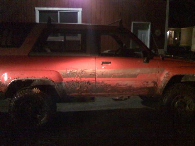

what will my 1986 4runner fit under it with a 4" rough country lift on stock rims? i Know rough country says 33x12.5's but everyone on hear says you can clear 33's with alittle triming. So im thinking i must be able to clear 35's!

AxleIke's Avatar
Joined: Apr 2004
Posts: 5,464
Likes: 6
From: Arvada, Colorado
Look at the top of the page. Mine is on 35's and has no lift. You'll be able to fit 35's just fine.
