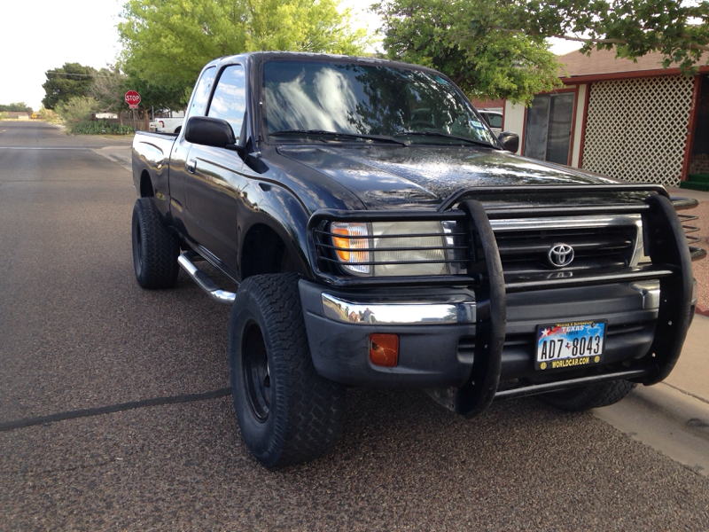

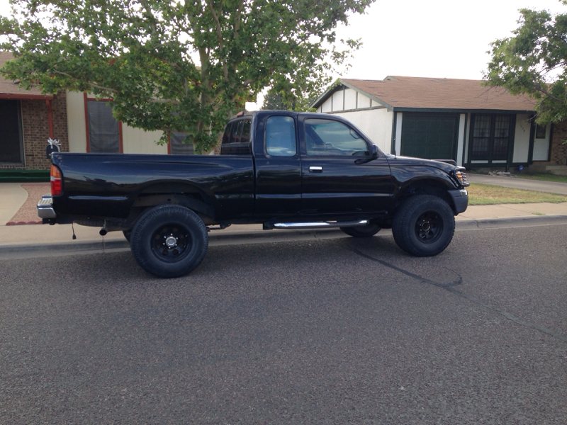

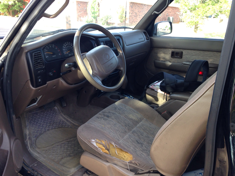

Hey guys,
Just wanted to introduce myself. I purchased a 1999 Toyota Prerunner this weekend. I bought it for $1,200. It has power windows/locks, cold ac, 32x11.50R15 tires, and a lift. The truck has 176,000 miles, it is a 3.4L V6. Previous owner thought it had a slipping transmission as the RPMs wouldn't go over 2,000RPM. I bought it and immediately changed air and fuel filters (both which were NASTY!) I changed out the TPS sensor and still the truck wouldn't go over 2,000 rpm and the truck had no response if you gave it more than 1/4 throttle. I tried cleaning the MAF which made the problem even worse, so I went out and replaced the MAF with a new one, and guess what, IT WORKED! I now have a good little beater truck that has a good transmission and everything, all for $1,200!
