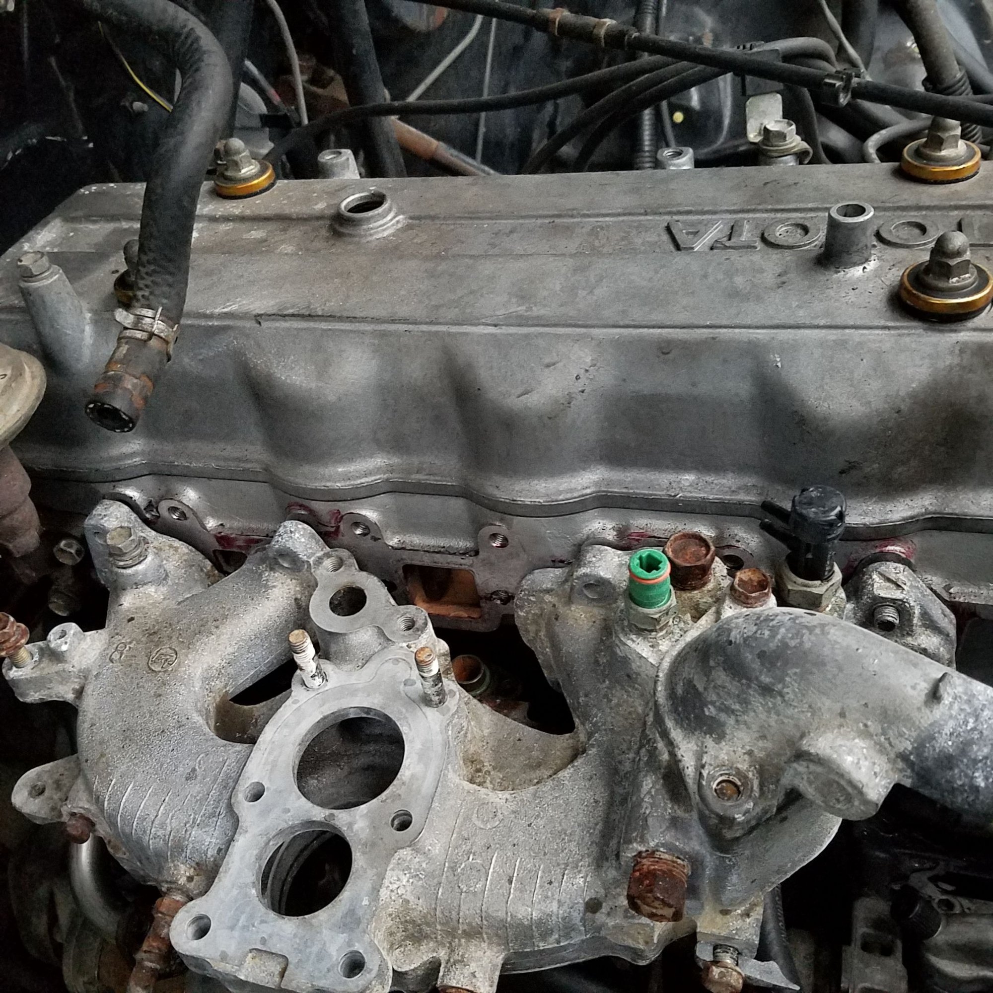

Extra ports?
Same head should be bolt on. No issues. Only time is if you would change head the and go with 20R head and 22R block(then, it has to be a specific early year 22r block,etc.).... and in that case, you also have to change to "DISH"(?) top pistons, have the block 'decked', etc. It's a bit of work from what I read, and some things can be skipped on that mod(20R head with 22r block)...but if you skip them, like the pistons, then you'd have even less power than with a stock 22r, ....so why bother, right? haha.
Far as the Orig. Poster, ...I thing I guessed right as to what he is thinking..but I'll wait for him to say, lol.
I'm trying to figure out what to do with the extra ports on the head. I am converting to 22r and have the parts i need but when line up the intake manifold there are 2 holes that are left open. I belive i can just block them up but not sure. Got any advice?
What to do with that open port?

Is there a block plate?
Originally Posted by ExB16ner
I have both 22R & RE complete engines sitting in garage, they look identical
On the 22r where the intake manifold bolts on is there a port blocked off towards the rear of the head? I got the intake manifold today and went to match up but there is a port that's not covered. Any ideas?
