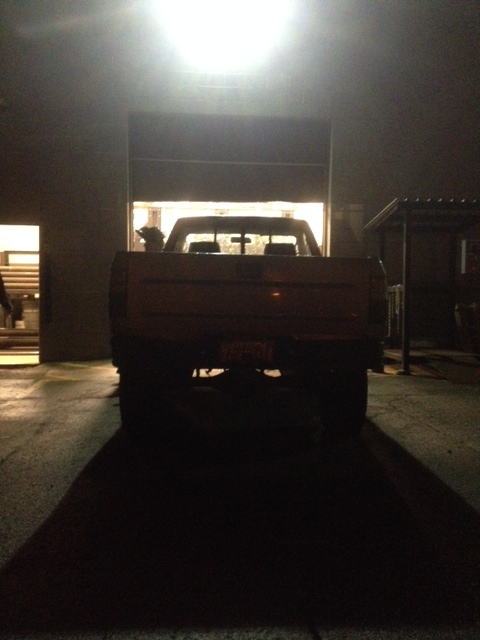

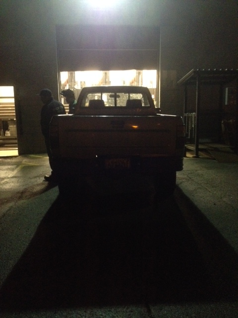

The front seems to be fine. measurements are good. its just the rear. ill try and post a photo
Old Oct 17, 2013 | 08:05 PM
AndyKrashYota's Avatar
Joined: May 2013
Posts: 73
From: Anchorage Alaska
here are a few if you can notice

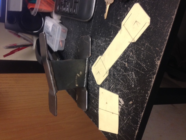

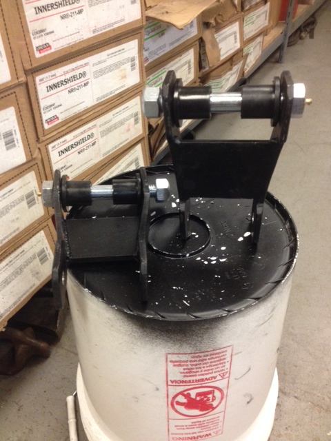

these are the +2 shackles i built

Kinda seems like the frame is bent/twisted VIA the crooked bed... but the picture is dark and its kinda hard to tell...
Perhaps some replacement springs are in order...?
