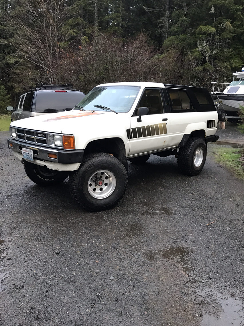

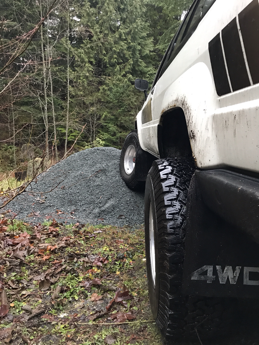

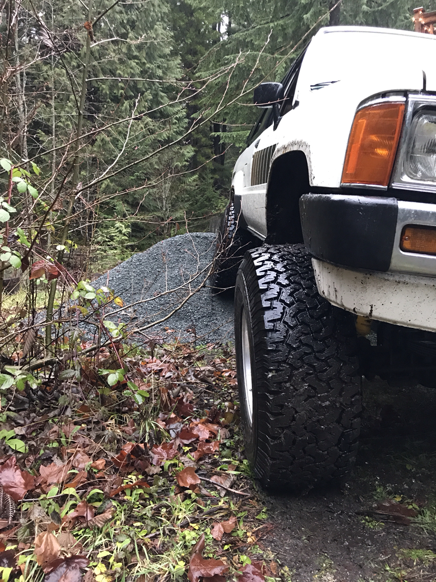

Old Dec 12, 2019 | 02:40 PM
thefishguy77's Avatar
Joined: Dec 2011
Posts: 2,179
Likes: 62
From: sammamish, wa.

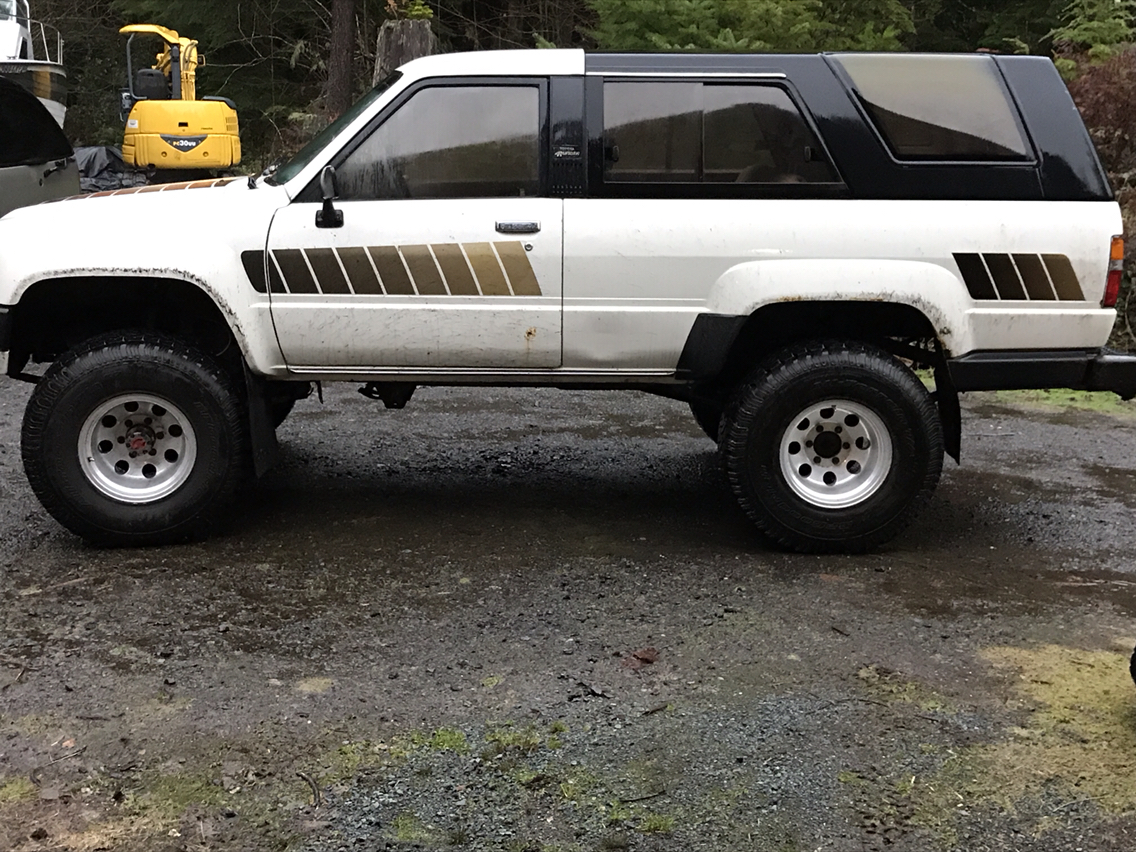

Ok so got her back on tires. Still need to bleed the brakes. Cant wait to drive it. The drag link is close on clearance. Like very close. Will try and remember to take some pictures tonight.

Old Dec 13, 2019 | 07:40 PM
OldBlueMidnight's Avatar
5 Year Member
Joined: Jun 2019
Posts: 201
Likes: 75
From: Vancouver, WA
The stance looks sharp! I've probably only got about an inch of clearance on mine with the wheels pointed straight ahead, seems to get better when they're turned, or with the drivers side wheel in the air.

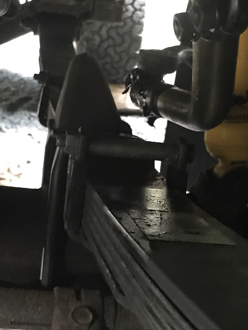

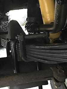

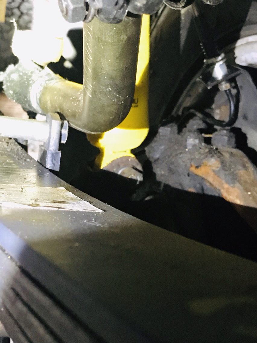

Old Dec 16, 2019 | 12:07 PM
Joined: Dec 2011
Posts: 2,179
Likes: 62
Ok so here are my ics of the drag link. I have not tightened the clamps to keep it from moving. The only time it is close is straight. Then its damn near touching. Can I clock it to towards the drivers tire so I clear the whole time? It only contacts if its perpendicular to the ground.

Old Dec 20, 2019 | 03:22 PM
Joined: Dec 2011
Posts: 2,179
Likes: 62
Ok so I clocked the drag link off to the side and that seemed to eliminate any interference issues with the spring rebound clips. Drove it around my driveway and property and I like it.
Thanks for the help
