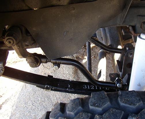

As I said in your other thread...I used a Procomp which is designed for about 3 inches of lift. Frankly it's the only one that I could find that would work. I think Skyjacker makes one as well but it's for more like 4 to 6 inches of lift. It works fine and if I remember correctly, cost something like $175. I ordered it through a local shop but you can get them on line as well.
Here's a photo:
Attached Thumbnails Whats the Best Drop Drag link and why?-draglink-small-2.jpg

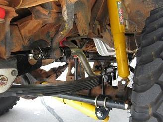

I just installed a pro comp drop drag link along with my new pro comp 4 inch lift springs and the new link works great so far.I got my stock steering radius back and it didnt wander all over the road when I test drove it. I will get crossover steering and be done with it, but for now this setup will work just fine.
I noticed in the picture, the newer drag bar for keeping the axle centered.... where did you find that beauty?
