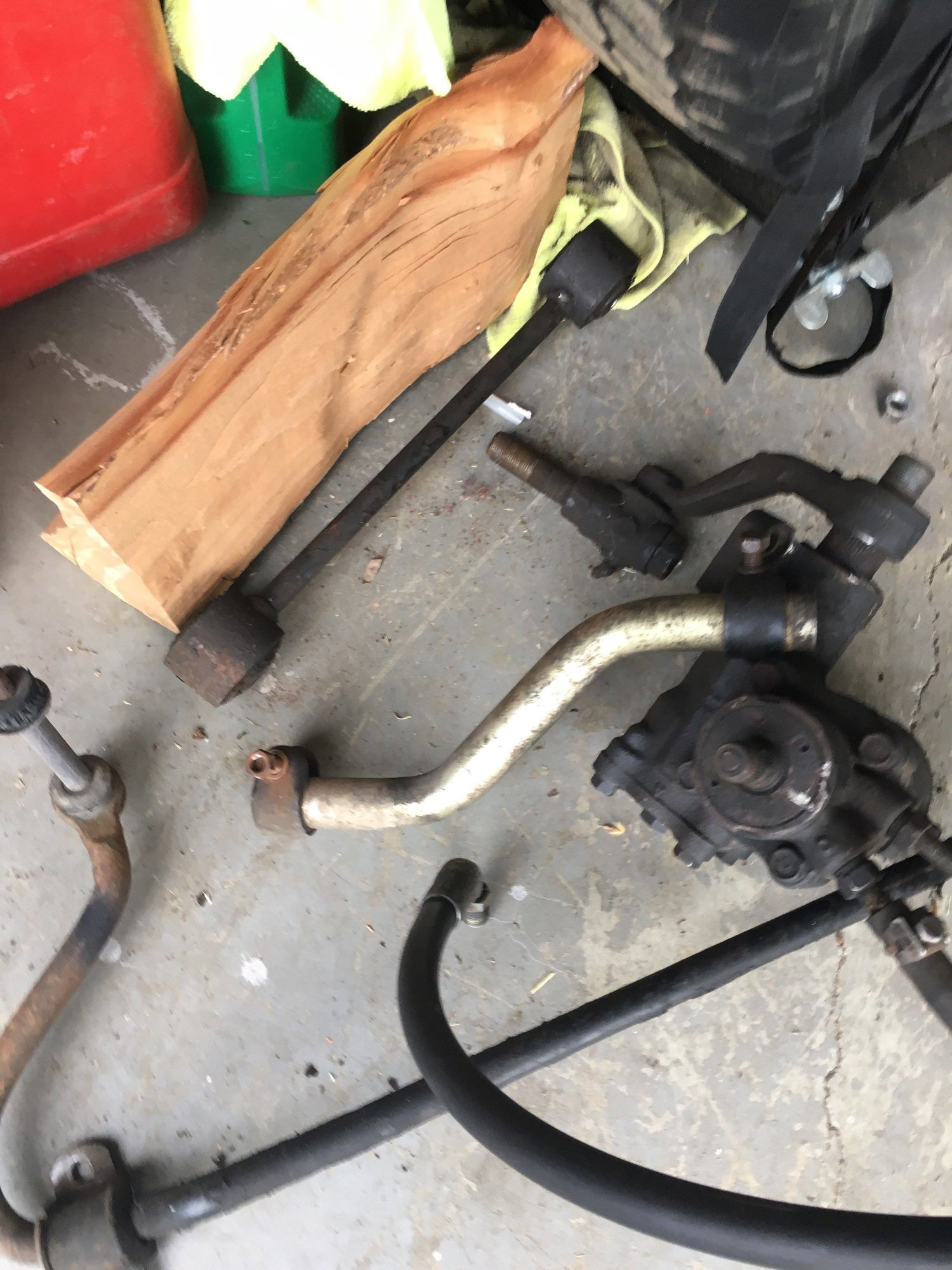

So after years of abuse the drag link on my 1980 4x4 gave up and fell off the pitman arm. I finished removing the drag link and was able to dis-assemble one end but the other end is a problem. The end cap is damaged from a previous owner and even if I can get the cap out the cup appears rusted in and the slot in the arm is wallowed out from the ball rubbing on it. The truck has little or no lift on it so I don't think a drop style drag link will work. I already have a rebuild kit but I think this drag link is not repairable. Does anyone know where I can purchase a new drag link? Thanks

My drag link is 20" long, here is what the ends look like. The boots were both rotted off. Illannoy road salt didn't help this situation either
I was able to get this one apart
bottom cup in picture is rusted in, still soaking it with PB Blaster

Yeah that looks pretty terrible! I'll throw a tape on mine tonight and will sell cheap if you're interested

I have made a lot of bad choices in my life but putting that back on my truck would rank up near the top! Let me know what yours looks like, definitely interested

Here is what my drop drag link looks like: I have both of the ends although I think they could stand to be replaced.

Thanks for checking for me, I don't think the drop style will fit though. No salvage yards around here any old Yotas, I'll either hit up Yota Jim's or fab one out of round stock.
