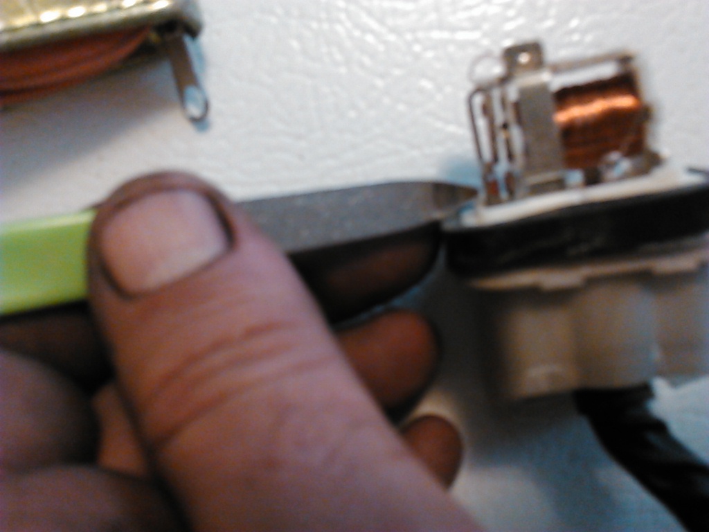

I clean my Starter Relay Contacts.
Cleaned the Starter Relay Contacts. Bend these 6 tabs that hold the cover on.
Here is the contacts that need cleaned on these.
