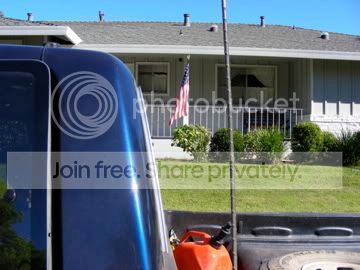

I put mine on one the tie down hook near the front of the bed. I rarely ever have it hit the cab. Mainly only when I enter my garage or anything. It stick's up plenty far and looks really clean.

thanks KEVININSAC that does look pretty clean, and thanks for taking the time to post up pics. I think i like NIX4X4's idea of putting it on the rear bumper, and i think ill get some kind of quick release.
