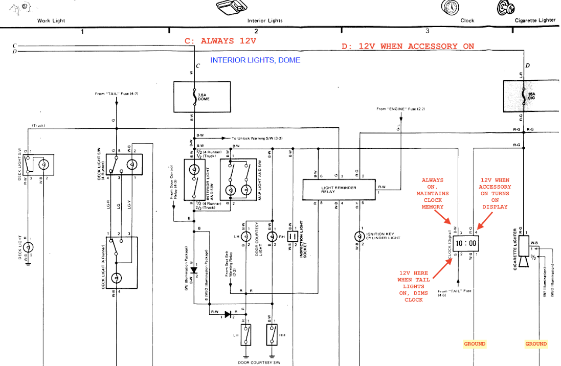

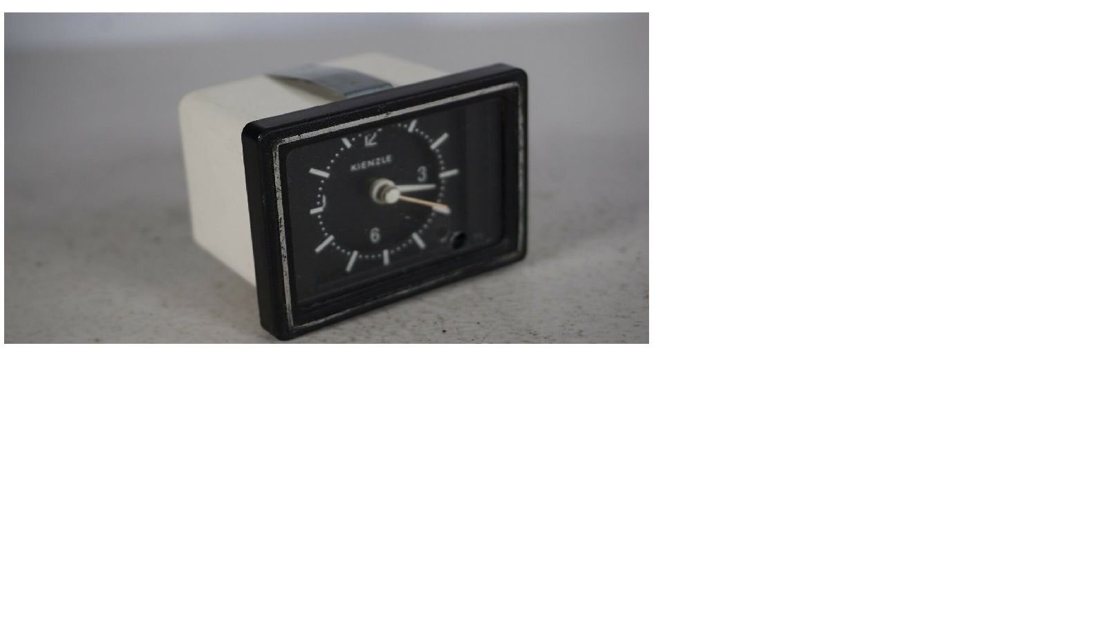

I've an 85 C&C pickup/Dolphin RV and I want to install an analog Jaguar clock (fits the large square dash hole left of the glove box). I fpind an open 4 wire socket behind the hole, which may be for that purpose. I can't find a reference for a clock or that socket on wiring diagrams. ANyone have any experience with those?
I know I'll need alway-on power, dash lighting power, and a ground.

From 1988 4Runner Schematic.
Should function same but not sure about wire colors, so use a multi-meter to check each wire function.

Thanks to RAD4Runner I got enough info to find correct color codes to finf power and ground to tap to make the Jag clock work. Hope to tap into gauge cluster illumination for the back light so it dims the same as gauges. Fits perfectly, snaps in place. May need to pull the cluster again for access (put in a 4Runner "real" gauge cluster previously)

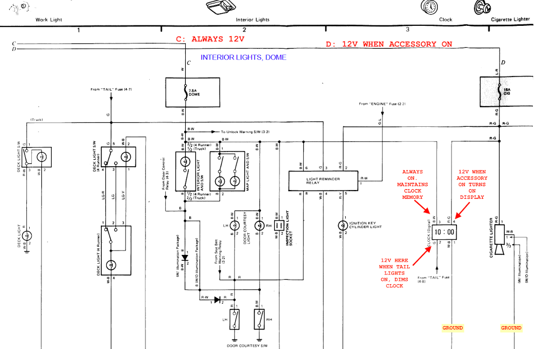

Thanks RAD! I have the same wiring diagram but your "Wiring for Dummies" helps the electrically challenged like myself. Hopefully I can find that pin connector.
