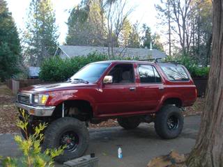

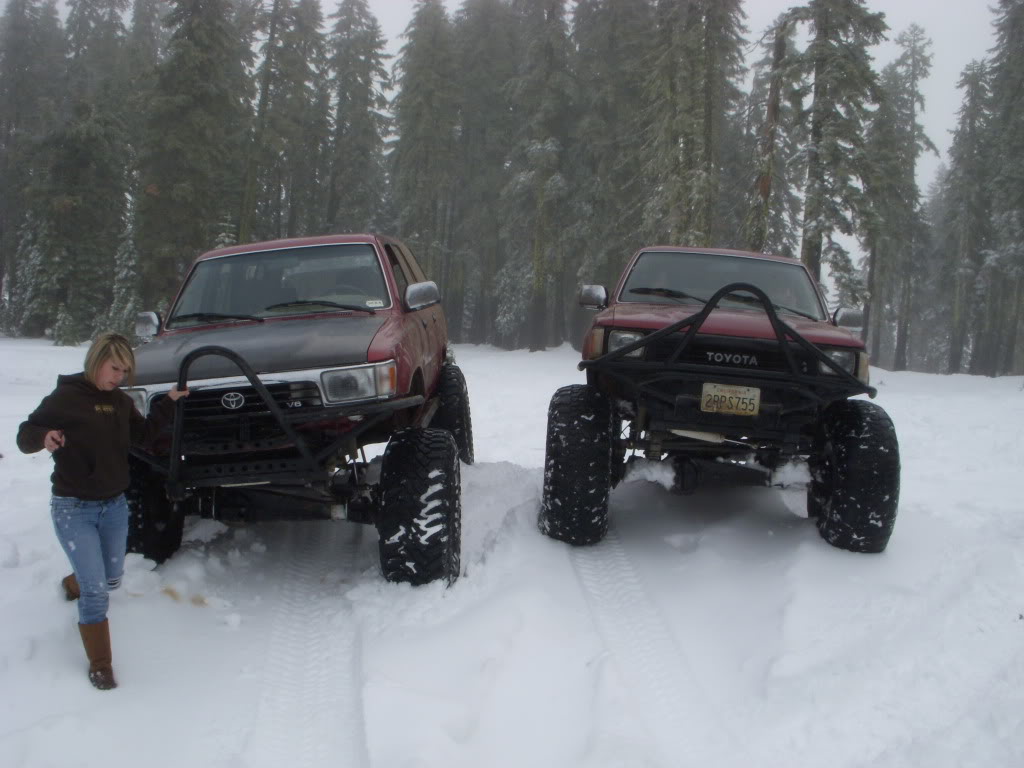

Okay here is a couple pictures of mine..
It is a trail-gear 4" kit.. Installed it in mid jan of 2009..
With 33's.
with 36"s
and with 40"s
Not a ton of up travel, because i am running bump stops, and because of that they BARELY rub under full stuff...
For comparason.. My 4runner on 40" iroks with the 4" tg kit and my buddys with some 37" toyos with a 5" all pro set i believe.

oyah im going to look into that FJ80 axle when i up size, and would love a rear e locker hehe. thanks im going to check those links
haha 904 i have been watching your build for a long time and on 33"s it looks sick, on 36"s it looks sick, and on 40"s just awesome lol. though i think my limit will be 36"s haha big for a std cab like mine.
i just need get some money so i can get to rebuilding my sfa and work away at this until i have everything including bigger tires since i am not going to run 31"s sas'd haha. i hope i can get it going soon, ifs is so annoying, i just want it gone and out of my head.
