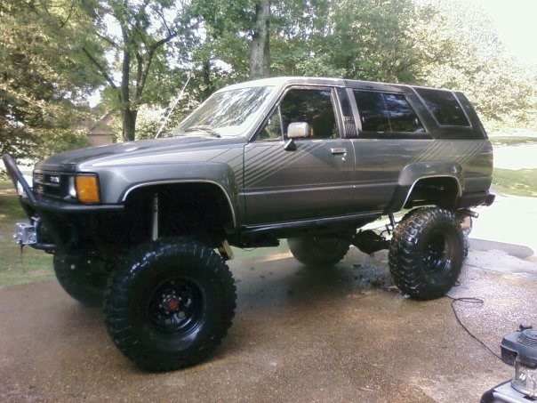

I have used nearly 100% trailgear products when building my truck and i have been very satisfied! The sas kit is all there and super easy and CHEAP! I pulled my truck in the shop friday night, and it came out of the shop early sunday afternoon ready to drive to school. (i was only 17) But if i can give you some advice, PLEASE dont make the mistake i did and get it too high!! KEEP IT LOW AND CUT! here is an example of what is too tall!
or this could happen...
