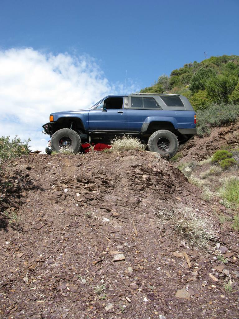

Just for comparisons sake, mine is TG 4 inch front and 5 inch rear kits. It also has a 1 inch body lift. The rear also got some other tweaks at fab time. We went with 1 inch longer shackles than come originally in the TG kit and also built up the mounting point on the frame for the rear shackle mount by 2 inches.
I haven't tried 37's yet but as you can see in the pics, there appears to be plenty of room. The truck is much bigger than I anticipated so I'm actually hoping for some settling in the springs. If it does settle significantly, maybe 37's won't fit. We shall see. You might also notice that I had to modify the wings on my rear bumper due to rubbing. (not modded in the first pic, trimmed back in the others)
I agree wholeheartedly with whokrz. Get locked in the rear and armorerd appropriately and you can have some big fun. Before the SAS that is what I did and I (pretty much) kept up with the 35" boys. Lockers and armor will transition right over to your SA project. IFS mods will not and IMO don't give you much return on investment. Decide on a body lift size before sliders if you go that route. I wish I had a 2" now but...

nice runner! hows your body roll? does it feal too top heavy or would you rather it be lower?

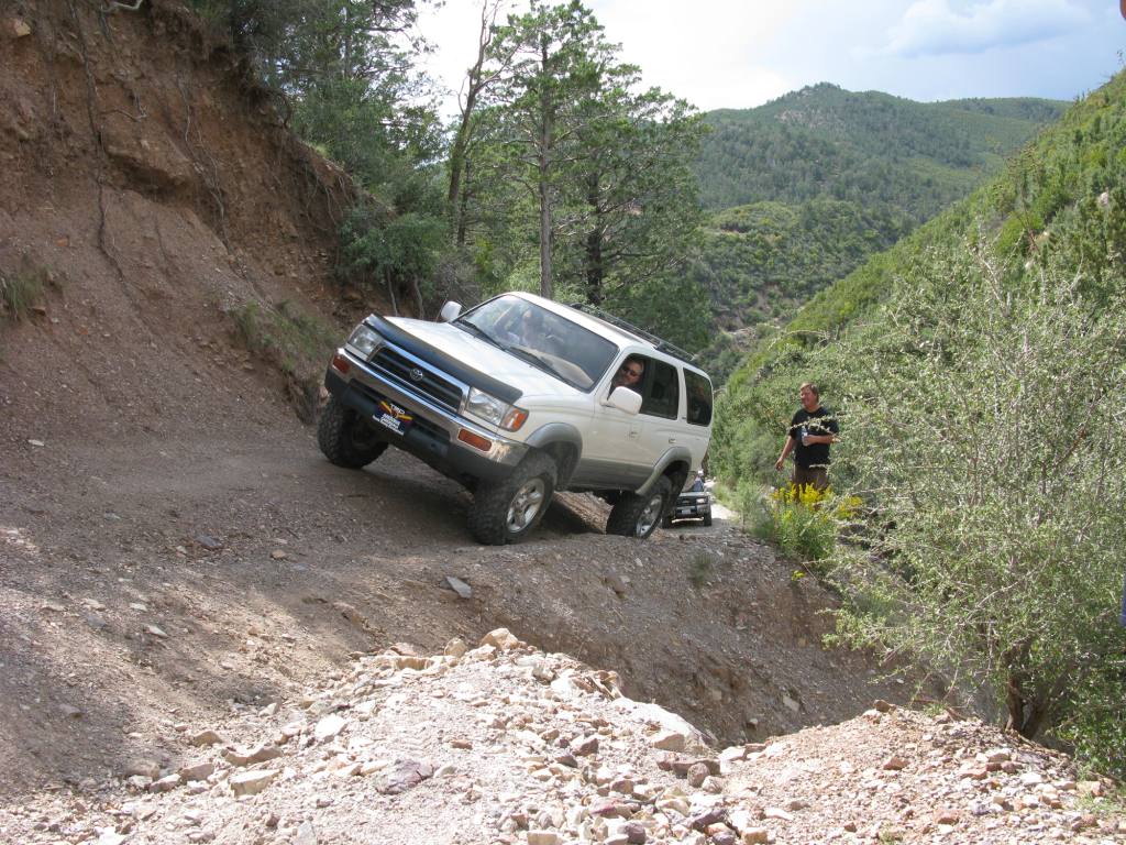

Thanks.
Short answer is I wish it was lower.
The longer answer is that all in all it feels pretty dang stable for the most part. I don't have much seat time yet since the swap so everything feels "different" or "a little funny" right now. Pucker factor was high when I went across this thing.

Fortunately I have the option of yanking off the top to lighten it up some.
