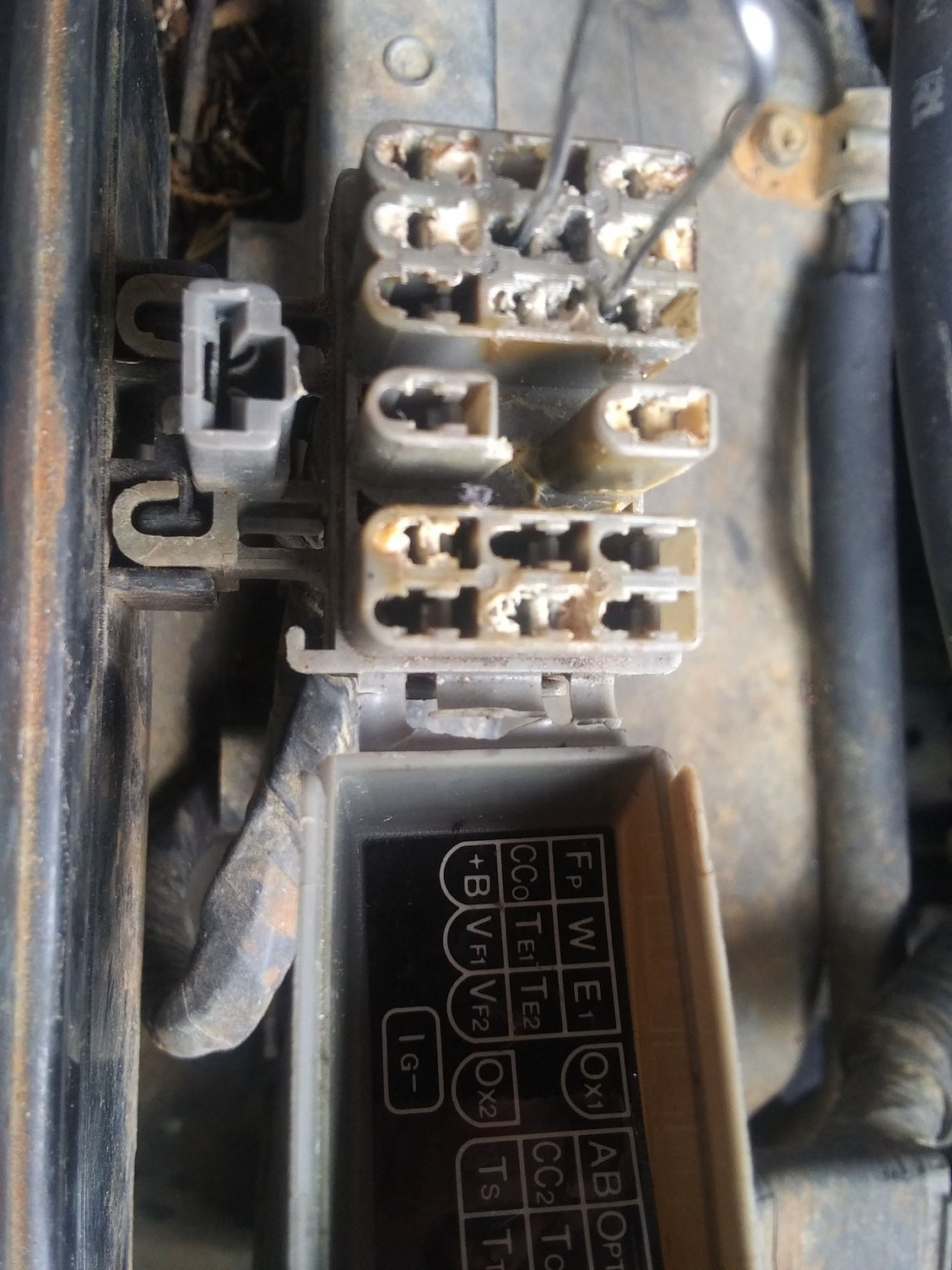

The first thing you should do is check the Engine Computer for codes.
To check for codes, find the "Diagnosis" connector by the under-hood fuse box and jump the E1 and TE1 terminals to set the Engine Computer into diagnostic mode. The jumper can just be a paper clip bent to reach to both terminals.
Turn the ignition switch to the "ON" position and count the number of flashes of the check engine light.
Below is the factory procedure for checking codes and what the different codes mean.

I have been trying to do that. Once I got it to continuously flash now it wont flash at all. I have put plugs, wires, cap, rotor, fuel filter, changed fuel injectors, fuel pressure regulator, fuel pump relay, ignition coil, temp sensor, afm sensor, tps, fuel pump, n EGR valve. I didn't mind changing all those parts on a 25 year old truck, but I'm ready to get it fixed and just drive it. fuel mileage went from 18mpg to about 10mpg when this started happening.

Take a picture of you jumping the diagnostic ports. Just to eliminate any silliness
Old 03-11-2019, 02:01 PM
rlw0766's Avatar
Join Date: Mar 2019
Posts: 8
Received 0 Likes on 0 Posts
I just tried it again. I also printed the link someone sent and followed it.
Old 03-11-2019, 05:50 PM
rlw0766's Avatar
Join Date: Mar 2019
Posts: 8
I followed that link & it flashed a couple times then quit flashing n stayed on solid again.
most likely not making a good connection in the diagnostics port
Thanks, I have tried several jumpers but will look into it more.
