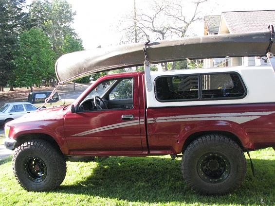

this can be done i threw a set on yesterday and did some minor sheet metal convincing and WAMO.
not much flex before the rear is STUFFED. but im just DD it for now.

Was the 9.50" to small? Should I go with 10" at least?
