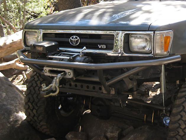

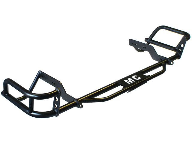

Explorer Pro Comp stage 2 lift
and yea. im just gonna put the body lift on and get it done with. so ill have roughly 7 inches of lift with 35's
welded on a flow master 40 series today. sounds hella nice. not to throaty. but its deep.
next topic is. bumpers
i dont wanna mess with the mouting brackets at all for the marlin crawler bumpers.
but i was thinking of adding another section of tubing to the top of thiers if not 2 more sections that way it comes up to the new level...
does that make sense? or am i talking crazy here?
also i want to weld on diamond plate to the font and back bumpers.
on the front one whereever there is open space. but mainly on the top of it so i can mount 4 hella 500 lights
so the front bumper would be boxed in. with another 2 sections of tubing on top for the body lift difference.
and the back bumper just boxed in where the corner protectors are
MAKE ANY SENSE?

I could imagine a second tube parallel to the lower tube on the front bumper, with diamond plate (aluminum?) closing it in but I prolly wouldn't do the plate.
And the rear... I think I'd try to find a way to lift the bumper up so it hugs the body like it's supposed to.
