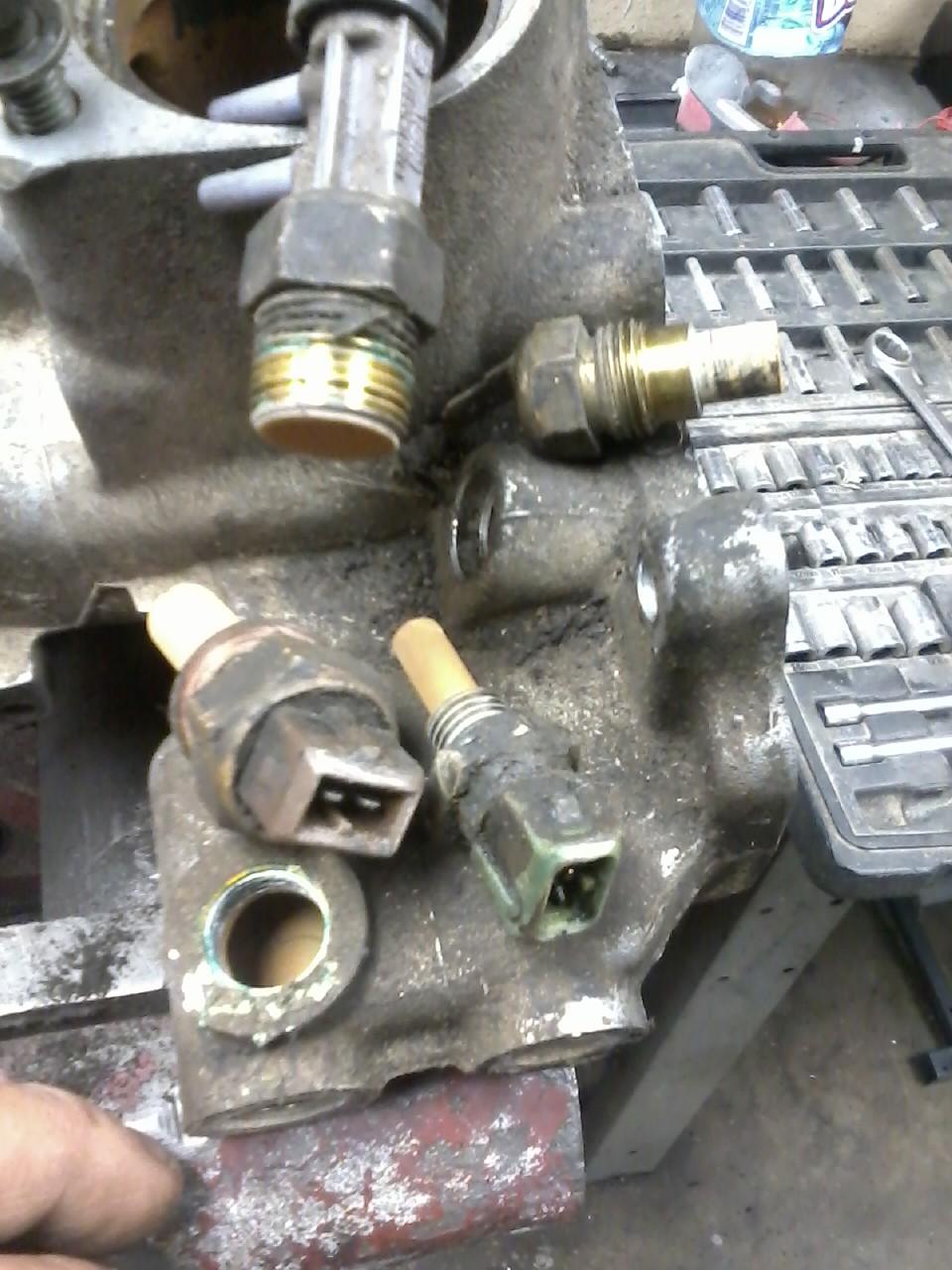

When was the last good tuneup? Plugs, wires,cap,rotor, air and fuel filters. Check for vacuum leaks, all hoses routed correctly, make sure lines coming off of the Plenum are plugged with carbon. Give all your sensors a good scrubbing. Cleaning my Cold Start Injector Timing Switch fixed one of my problems in the winter. Probably not your issue right now, depending on where you live, but it is a good start on what could help.
Copied...
Here are the dirty sensors. Cleaning temp guage one in between #2 and #3 cylinders has helped my temp guage to be more stable then jumping around.(Top Right).

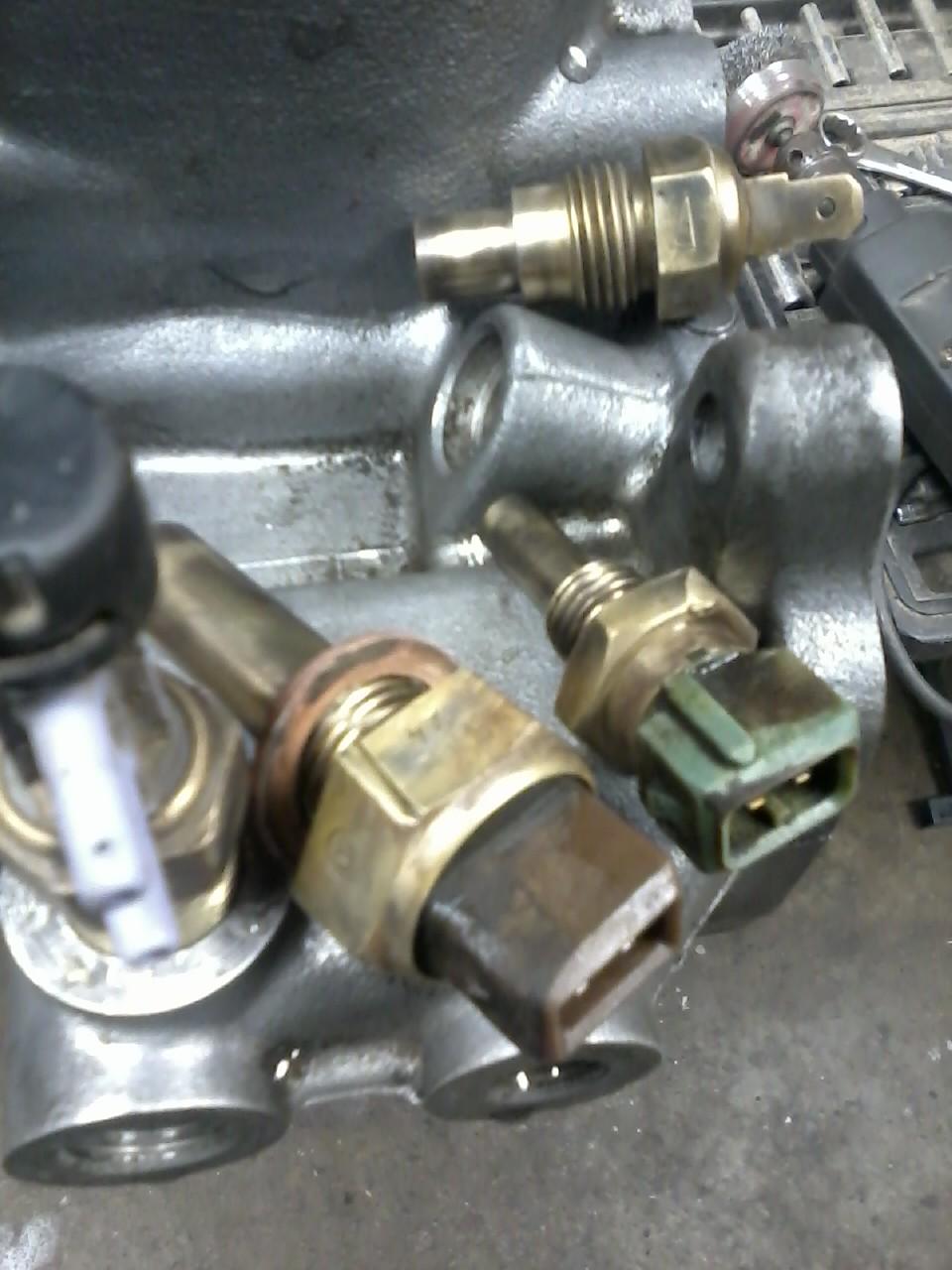

Here they are cleaned. I just use a brass tooth brush and water to get them cleaned. The manual says to wrap the Cold Start Injector Time Switch (Sensor with Brown top)with plumbers tape. I do them all. I haven done it yet but will when I put the motor together.

Old Jul 25, 2013 | 03:01 PM
GCAMM's Avatar
Joined: Jul 2013
Posts: 9
Thanks Terrys87,
I just bought the truck about a month ago, so i don't really know everything about it... I assume it has been a while since a good tune up was done since the guy was selling it...
Was your response meant to have photos in it? I see reference to "top right" and what not, but no photos...

Old Jul 25, 2013 | 03:22 PM
Terrys87's Avatar
Posts: 11,787
Likes: 28
From: Anderson Missouri
I am seeing the photos I posted. I was showing what the sensors look liked before I cleaned them and then the after I cleaned them shots.
