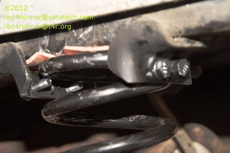

Originally Posted by Robert m
i dont know of any mishaps on hand but looking unsafe and hacked together
i just imagine one coming loose from vibration or dislodging and launching from the truck.
No need to imagine Springs are secure
My zuk mod here.

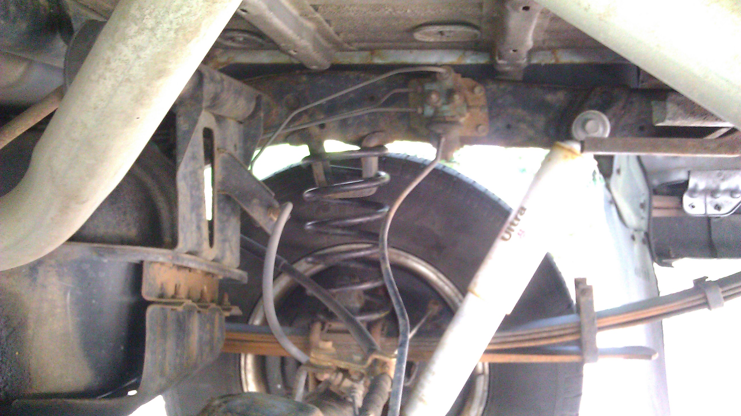

+1 No Cut No Bolt Zuk Mod on a '89 Runner
