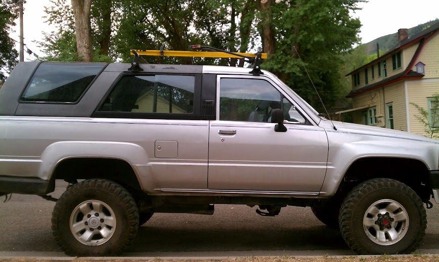

i have a no-cut TJ spring zuk mod.
my opinions are: it definitely put the ride height of the frame where it should be since the rear leaves were flattened out and i had that saggy-butt look.
i used 14" TJ springs cut to 12"... cutting the springs increases the spring rate (makes them stiffer). my truck rides really nice when it is fully (and i mean fully) loaded with camping gear and people. empty, its a little rough in the back.
there is no way at full axle droop for the coils to come out. i jacked my frame up, let the axle droop, then had to compress the heck out of the TJ springs to get them to fit between the bump stops. I realize just drooping by gravity can be shorter than a droop that is being helped by the opposite wheel being stuffed, but there is 3" of upper and 2-3" of lower bump stop that the coil spring is looped over. additionally, if the spring were to come out in a full droop scenario it would be totally uncompressed and would just fall out, not come flying out fully loaded.
i don't think you can zuk mod enough to provide an above-stock "lift" in the rear. it does a great job leveling your truck out if you have flattened rear springs. but it would not get you up to matching the lift height of a bj spacer lift. you may notice creaking, springy, and pingy noises from them after the first few rides (that goes away) and maybe some creaking when stuffing and unloading the rear end later on.
pic before:
pic after:
It was a little stink-bug (higher in rear) for a little bit after i installed. it has since settled to nice and level.

deruckus- what shocks are you using? i know after i did my zuk mod, the shocks was maxed out lol. i have since changed it but i did get an above stock height lift, at least 2.5-3 inches. since i dont know what stock height would be im kinda guessing. my blazeland LT up front gives me 3 inches of lift or so and my truck sits pretty level so the rear must be the same right??
Old Oct 11, 2013 | 09:11 AM
derockus's Avatar
Joined: May 2012
Posts: 299
From: GWS,Colorado
I used Bilsteins, dunno the model#. They matched the travel on the old beater shocks that came off it. You can see my build thread for how much it changed. I have a 2" body lift if my truck looks higher than stock.
