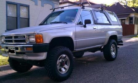

Hey people,
Just bought my first 4Runner off craigslist a week ago. I'm pretty stoked with it already. I was deciding between a J**p (no 4 letter words here, I know) and the 4Runner and I know you agree I made the right choice. The PO only owned it a short while but he did put some money into it before I got it from him. Poor guy was moving to ID and had to sell his toy, I'll give it plenty of use though.
22-RE engine. Odo says 198K. By the looks of it the engine was rebuilt at some time. VERY little rust overall. Spent most of its life in AZ from what I was told. PO put a nice stereo system plus amp/sub in it so that part is already sorted out. Also has brand new 31" rubber.
It needs CVs, new exhaust from the manifold on back (flumpflumps while idling, thinking it's a clogged catalytic and muffler since they are original, any other guesses?). He threw in 4 Bilstein shocks so I'm gonna swap those in also. Other stuff I want/need is a roll bar, roof rack with spare tire mount and space for offroad equipment, big lighting system, and maybe something badass to paint on the hood. Ultimate goal is just a backcountry play/camping/bike-shuttling/go-nearly-anywhere rig.
