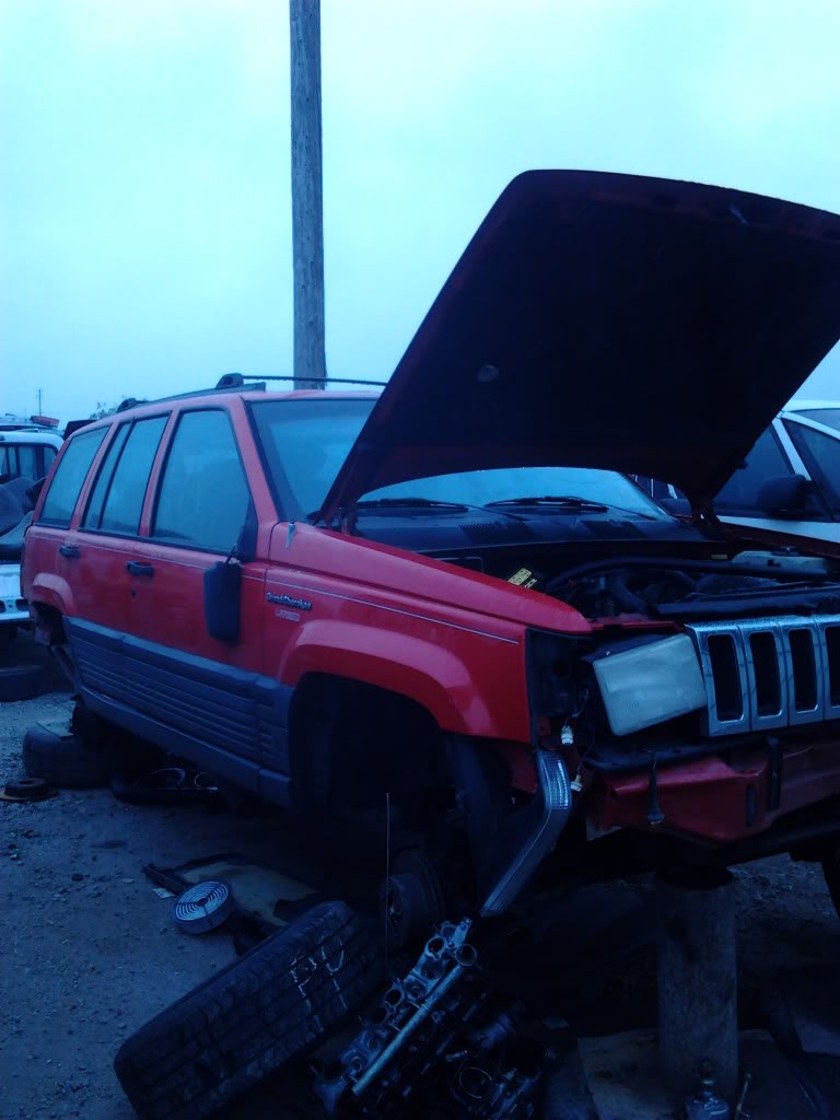

I used front coils from an early '90s grand cherokee laredo and cut them down from 18'' to 12'', and that was perfect for me. Name:  IMG_20120423_083412_zpsf2cac953.jpg
