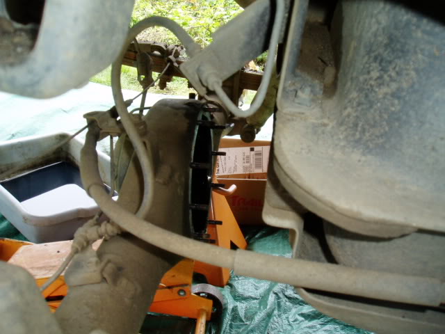

the ol "same thread bolt drum undoer thingy" that didn't work no more than fly to the moon! ahhahah I torqued on it a few turns and the metal tore away.
Got the third out anyway. Now I have to find a new drum
