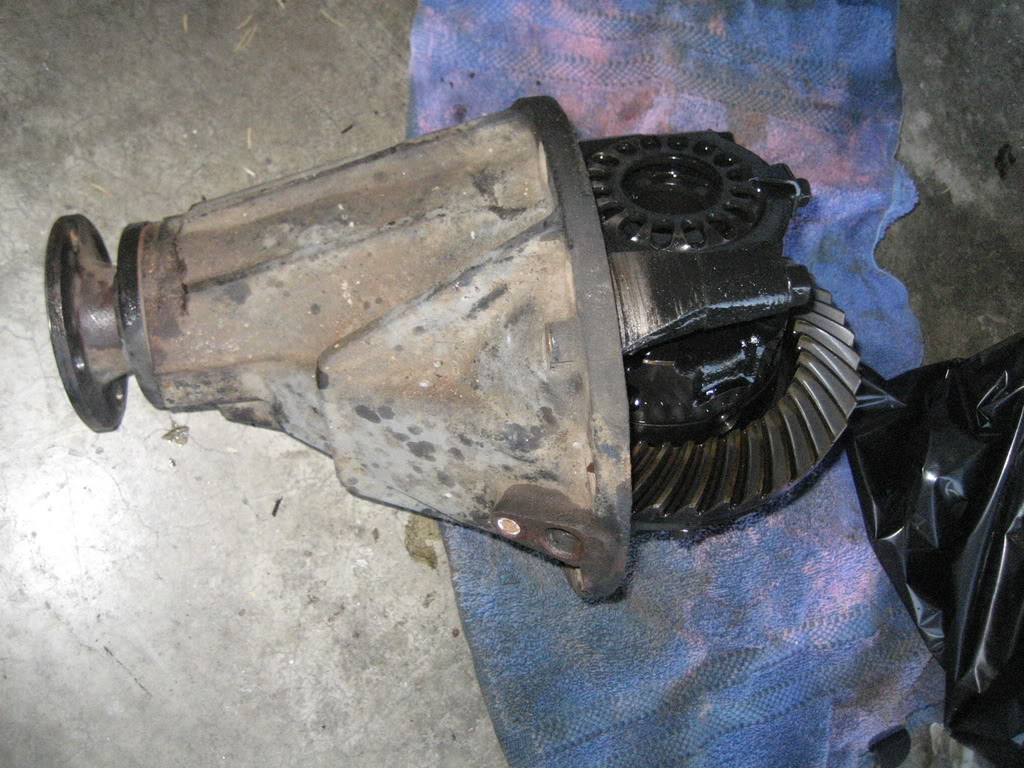

couple somewhat related pics

Good write-up! I have a question...in the pictures that you and SR5 posted, the middle part of the third(where the locker/spider gears go) looks different. Yours has a big hole to slide in the locker and his only has 4 little hole that you can look in and see the spider gears. What is the difference?? Mine is like the one that SR5 posted.
Please, forgive the ignorance.
Mike

The trucks and 4runners came with different rear differentials depending on if you got the v-6 or the 4 banger. Matt16 has a 4 banger diff, while SR5 has the v-6 diff. the v-6 diff comes apart right down the middle to install the locker and then bolts back together. the actual carrier is stronger too.

4 Cyl diff with two spider gears:
On the left is a V6/ turbo diff with 4 spider gears.
